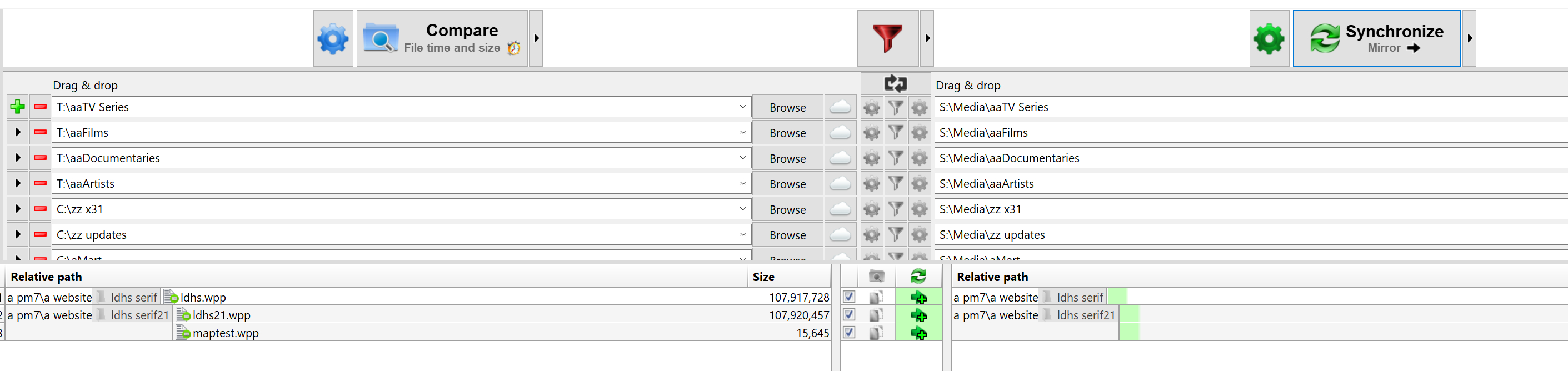

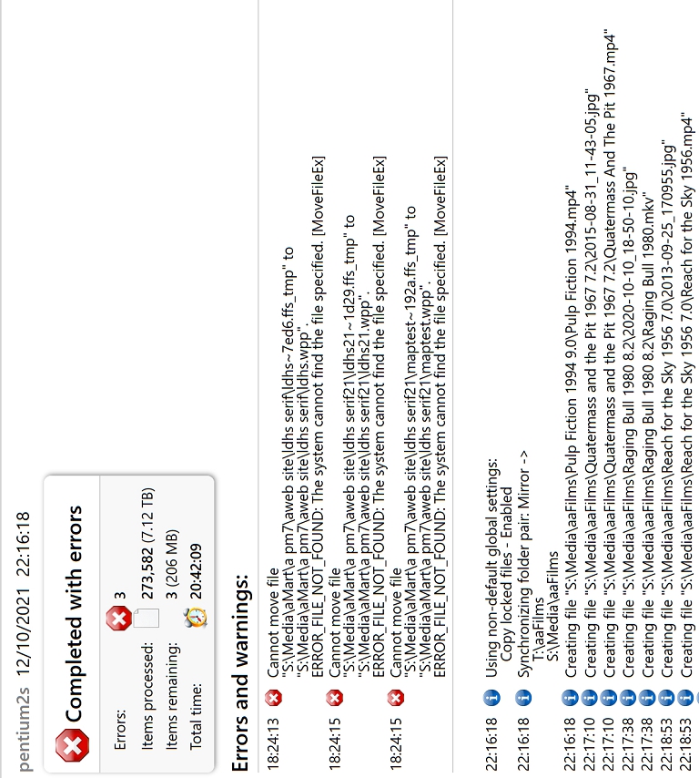

FreeFileSync works (almost) 100% backing up my data to a NAS apart from a certain file type namely *.wpp.
The files are located on C drive and the NAS is designated S drive. Everything else backs up fine.
Attached screenshots - any help assistance would be appreciated as tearing my hair out

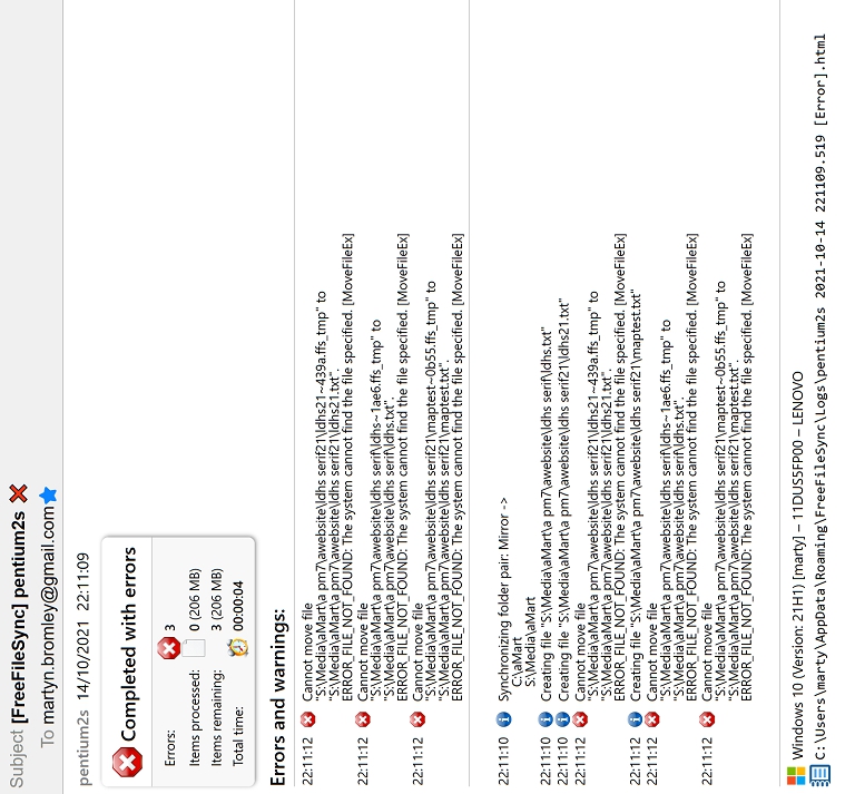

An update - apologies forgot to mention.
In the backup destination drive folder it leaves a file - ldhs~30ce.ffs_tmp which is 102mb. So the program is trying but not able to complete the action.

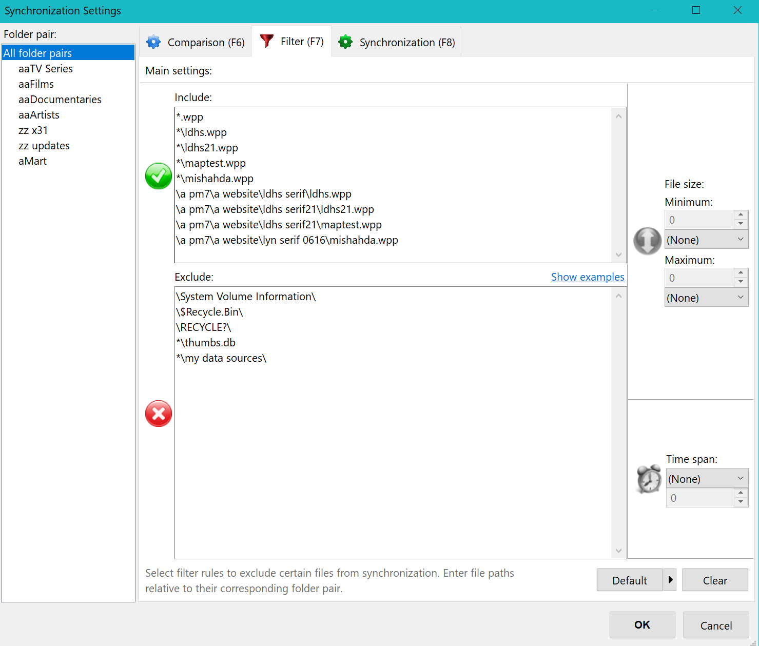

I would remove the filters you added. Good troubleshooting step, but that is not causing the issue. Something is preventing FFS from renaming the temp file it creates to the real name of the file. What is your NAS? A Windows share, a dedicated box like Synology, or something else?

Hi - thanks for responding.
Filters removed. I'm using a Synology 220J running 2x8TB drives as RAID0. The DSM is v7.0

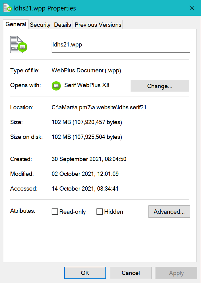

FFS is working perfectly with all other file types and other files within the c:\a pm7\a website\ldhs serif\ and c:\a pm7\a website\ldhs serif21\.
Other files which are far larger are backing up fine. It's just those with the *.wpp suffix that it stumbles over.

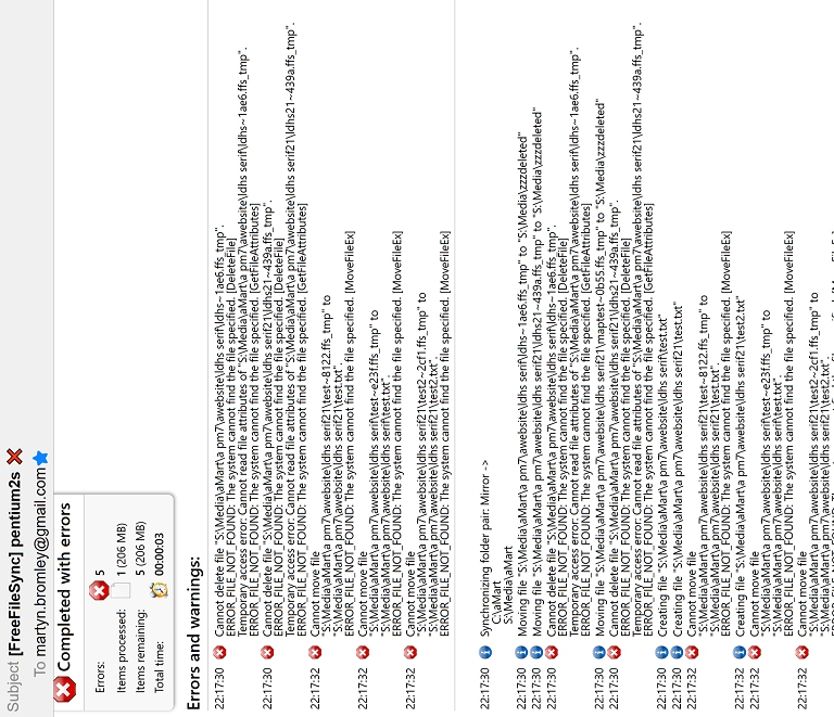

What if you simply change the extension of the wpp files to something else like txt, just as a test.

Hi - firstly thank you for your suggestions. Renamed the offending files to *.txt - a no go.
So tried renaming them completely to test.txt and test2.txt - still a no go.
I can manually copy these *.wpp files to the NAS.
However, a strange point, even when FFS is closed it creates the old files namely ldhs21~439a.ffs_tmp with a size of 102mb exactly the same size as the *.wpp. Have checked task manager and there are no instances of FFS secretly running in the background although it is scheduled via Windows Scheduler.

Sorry forgot to mention in my frustration - these old files on the NAS have been manually deleted previously. They are being recreated after I copy the files manually - the *.wpp ones across to the NAS. Same size and datestamp.

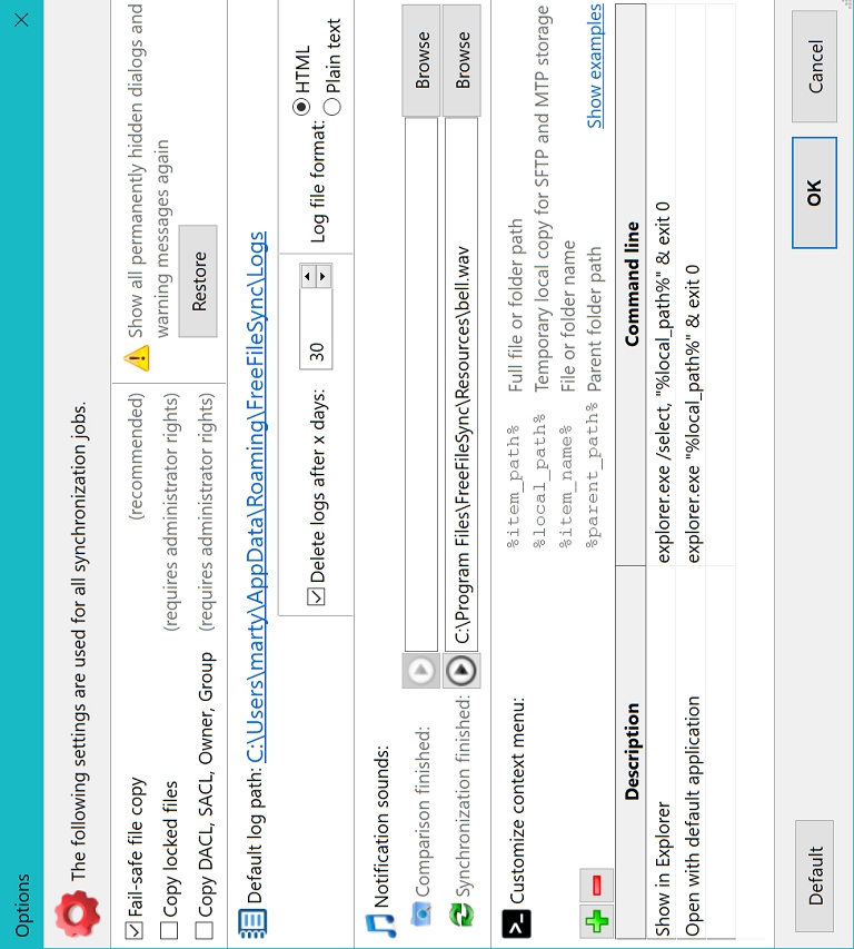

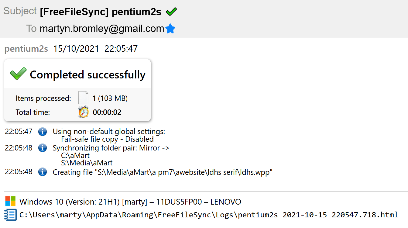

Just throwing out ideas...
Start with a new sync (new sync settings)
Set an Update sync, from C:\TMP to your existing S:\Media\* directory
(& make that C:\TMP a directory with a single .wpp or .txt or whatever file in it)
Does that copy successfully?
Disable Fail-safe copy
Any change with that?
Re-enable Fail-safe
Create a new directory on S:, say S:\TMP\BACKUP
Again copy from C:\TMP but this to this newly created directory S:\TMP\BACKUP
Did that work?
Might that NAS itself have some sort of sync or cleanup ongoing?
Re-enable Fail-safe
Did that work?

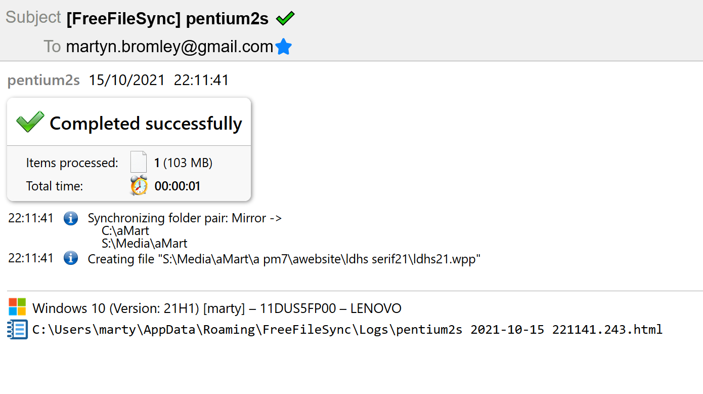

Throwing out ideas worked and reporting back in case anyone else has the same problem.
Followed your idea re c:\tmp and disabled File-safe copy. All worked fine. Re-enabled File-safe with a *.wpp file in c:\tmp - copied perfectly.
Then with File-safe enabled went back to normal backup without the *.wpp file in the destination. Hey presto - it works fine. So whatever disabling and re-enabling did under the hood rattled something around and everything now perfect.
