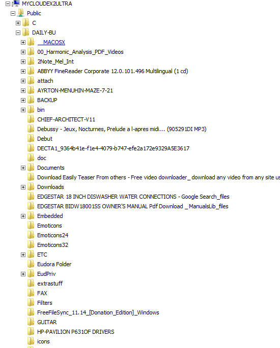

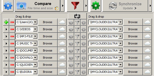

My next goal was to choose several subdirectories which are the locations for frequently changing files: email, financial data, downloads, etc. The configuration is shown in the screen shot attached. For this action, I chose UPDATE and assumed that the program would generate subdirectories (folders) as required by the choices made on the "left." What was generated was not a list of those same 'folders' but instead a lengthy listing of a mixture of files and folders shown in the second attachment (FFS-RESULT).

You are probably syncing all 8 locations to the same folder on the right side, can't tell with the small screenshot. Copy-paste the whole locations into the forum if you could. You are likely syncing
C:\Users\Owner\" to "\\MYCLOUD\Example\"
and
"C:\QUICKEN\" to "\\MYCLOUD\Example\"
instead of syncing them to
"\\MYCLOUD\Example\Owner\"
and
"\\MYCLOUD\Example\QUICKEN\"
respectively.
and
and
respectively.

Thank you. I suspect you are correct, but wonder where my reasoning went astray: When I did my initial "Mirror" of Computer C:\, the program copied the 'folders' exactly. I assumed that by choosing the 8 different folders, the program would do the same and create the 'folders' for me. I gather that if I wish to deal only with these 8 'folders' I shall be required to create 8 separate 'folders' on the NAS?

Correct. Although if you just did a full backup, wouldn't those 8 folders already exist? And you just need to select them as the destination for their respective source?

Thank you for your help and suggestions. I have learned how to include recent files only and followed you advice for establishing separate 'folders' on the 'right.' Seems to be working well. regards, Jack
