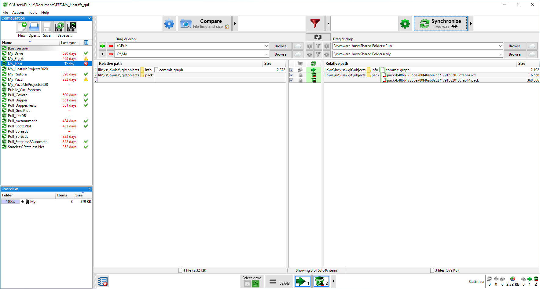

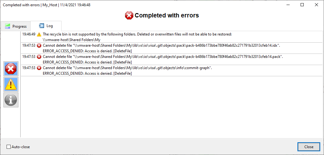

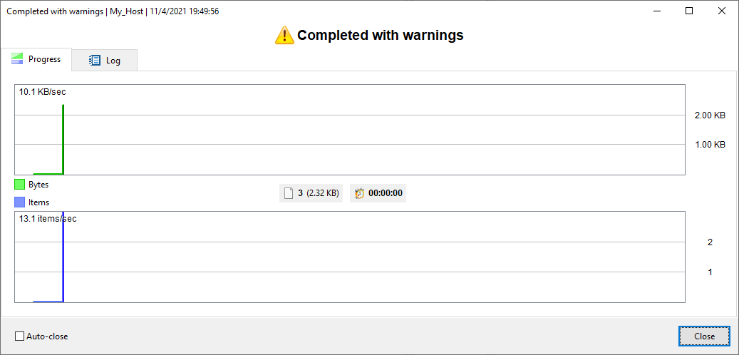

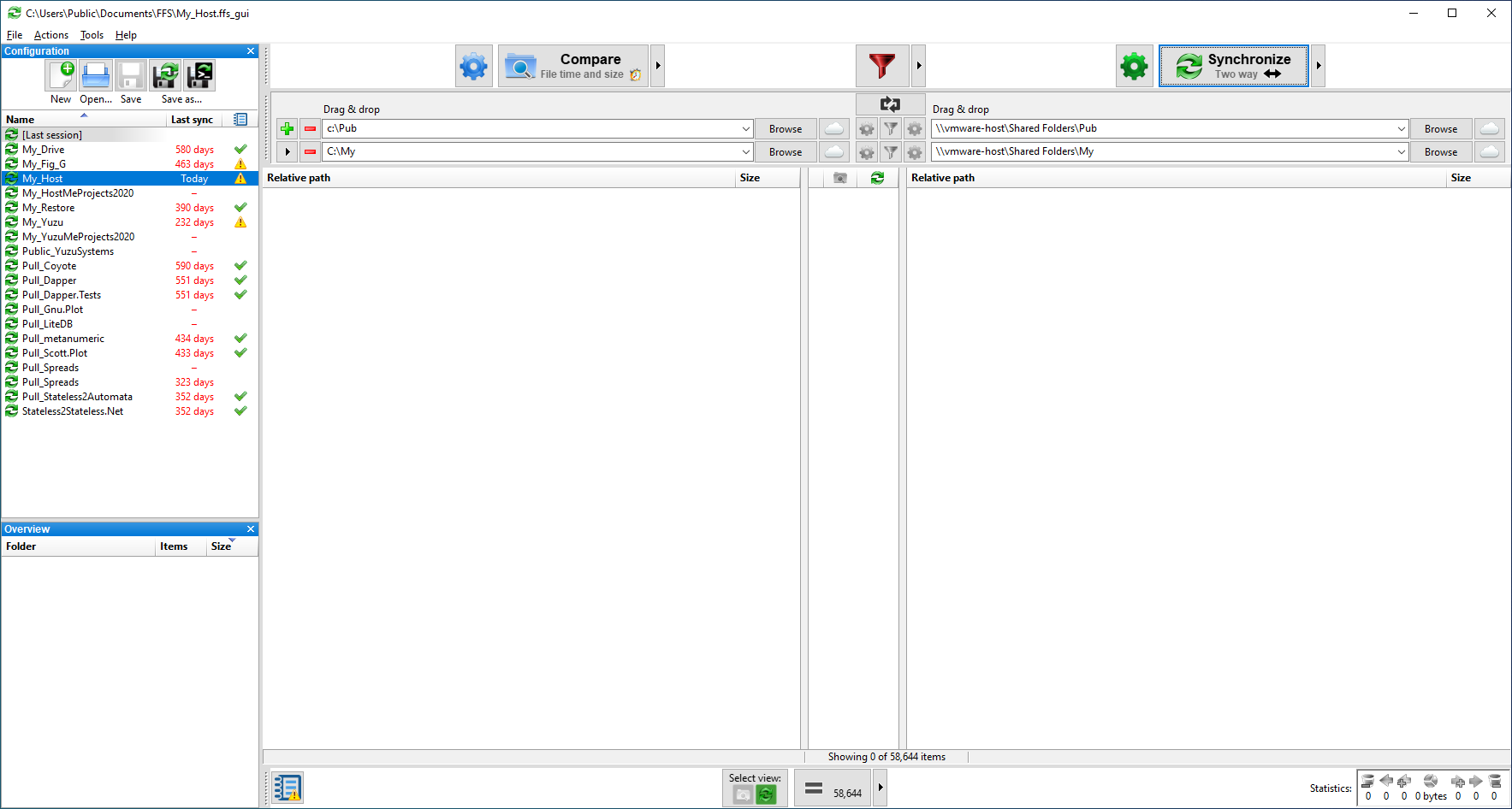

I attached a series of screen shots that I hope show how this manifests itself when synching with Free File Sync (FFS) and how synching succeeds on subsequent attempts without making any manual changes to unblock the files other than trying to sync again. Consequently, when synching GIT folders, every sync needs to be ran twice.
The first screenshot shows the first FFS message. A series of subsequent screenshots show how this is reported as the sync process proceeds. The last couple of images show what happens after I click Synchronize again where the files do get synched. More often, though, the second sync succeeds only after restarting FFS.
Access denied on git repo files

Pictures so others don't have to download:
Wow, thanks! :)Pictures so others don't have to download: xCSxXenon, 12 Dec 2021, 16:02
Of course! Now for the issue, I have no idea why that's happening.

For example, say I have committed some files to the repo. Now I have some data to sync, which include, among others, some files from the .git\objects folder that cause the Access Denied failure. When I sync, all files sync, including copy and delete, except for the commit-graph (for update) and the .idx, and .pack (for deletion).
