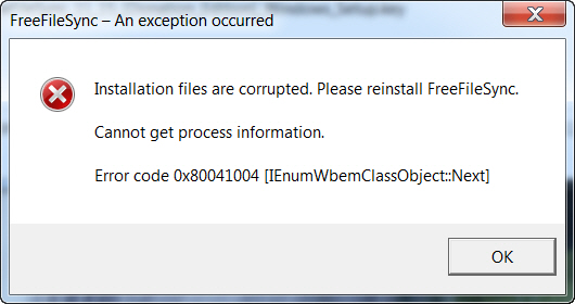

I get an error message at the end of the installation.
It says the files are corrupted.
I used Revo Pro to uninstall the program in its entirety.
I tried reinstalling but it is not working.
I tried many times with no success.
I tried restarting the computer that did not work.
I am using Windows Ultimate 7.
I connect to the Internet with a VPN.
Ver 15 installiation problem

- FreeFileSync ver 15 Install error 2022-01-01_23-29-25.jpg (81.08 KiB) Viewed 1458 times
- Posts: 7535
0x80041004 = WBEM_E_PROVIDER_FAILURE
I've added a workaround: https://www.mediafire.com/file/hm4umey1mrn8rxh/FreeFileSync_11.16_%255BBeta%255D_Windows_Setup%25282%2529.exe

I installed the free version 11.15. Shuld I uninstall it and then install the version 11.15 donation, then run the fix or
should I just run the fix?
Will I need a new key or can I use the key for version 11.15?
- Posts: 4934
You can just run the beta linked. It won't be donation edition though

You didn't get an update because he didn't update version 11.16, he just linked to a fixed copy before implementing it into the next stable release, presumably 11.17. If you have an active donation edition, it will be able to auto-update like normal.
