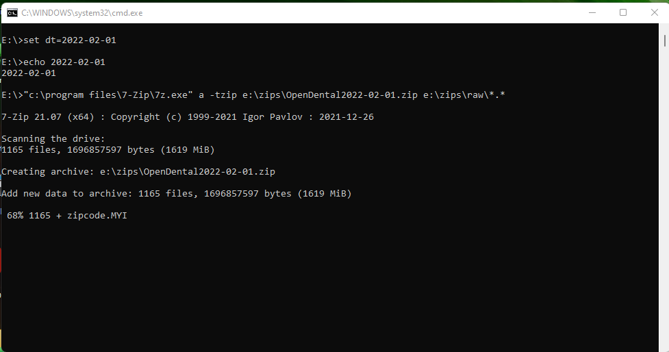

Here's the same batch file run from explorer by double clicking on it...
The zip files are created, they have the correct size, they can be opened and unzipped so the batch file executes, just without a window being created
JLM

If I add Start "" before the 7zip command in the batch file, it shows up in a window again
JLM

It still does not honor the pause command and the batch file terminates. For my purposes, it does not matter, I just need to know that 7zip has completed. If you close the ffs instance before the batch file has completed, it is terminated prematurely. I just need to avoid that.
