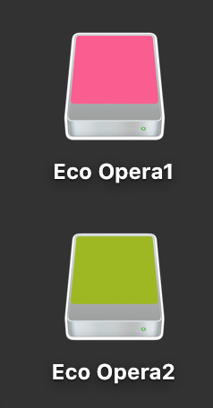

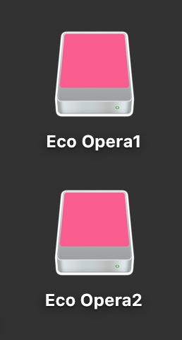

I've just signed up to the forum so forgive me if this has already been discussed, but I am trying to work out how to preserve custom Hard Drive icons when syncing. I worked out how to do it with folders by using */Icon? in the exclude filters, but this doesn't cover custom hard drive icons. I am using two colours to delineate between the master and backup drives but when I sync they change - before sync and after sync (mirror)
