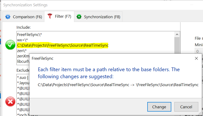

Using full paths seems to be a common error that FFS could detect and also fix in most cases. Implemented for the next version:
https://www.mediafire.com/file/2mb95odlrz3eby4/FreeFileSync_11.24_%255BBeta%255D_Windows_Setup%25282%2529.exe
