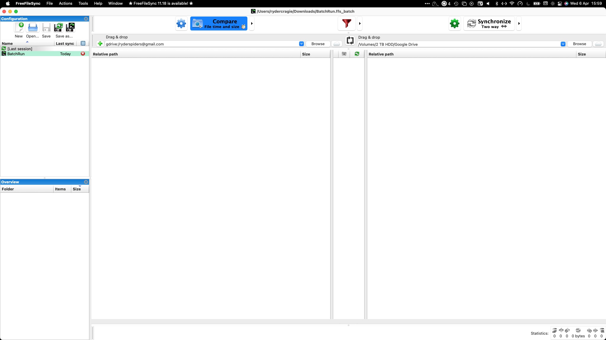

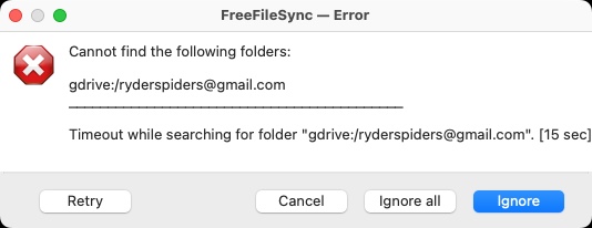

Ryder Cragie
I have a batch job for 2-way-syncing between Google Drive and my external hard drive, but I am receiving this error when I run it. Does anyone know why? I can scan perfectly fine inside the app and it lists all of my files in Drive, so there's clearly no issues accessing my data.
Screenshot 2022-04-05 163406.png (100.07 KiB) Viewed 7104 times

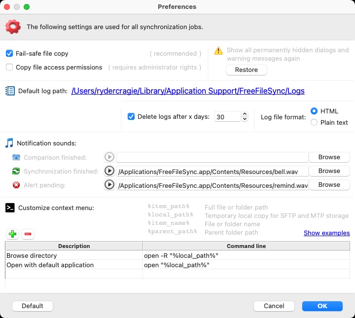

Posts: 7535
In this case it seems the config files are loaded from different locations. What location do you see when you open menu->preferences for "default log path"? And at which path are the logs for the batch job saved?

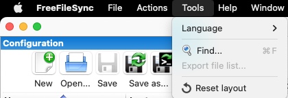

Posts: 4934
He meant to type:
Tools -> Options -> Look for "Default Log Path"
Posts: 23
Joined: 5 Apr 2022
Ryder Cragie
I don’t see “Options”.

I found it. This is what I see.
Screenshot 2022-04-10 at 23.31.36.jpg (119.58 KiB) Viewed 6947 times

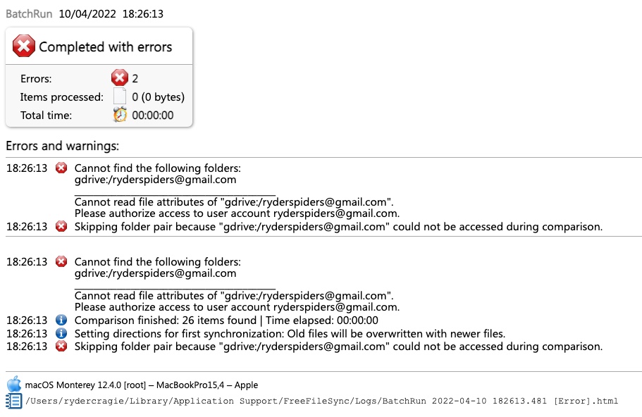

Posts: 7535
It says near the top. Ryder Cragie, 11 Apr 2022, 08:53
What I meant was for you to manually navigate and locate the folder containing the log files via Finder, that contain the info about the error shown on the first screenshot of this thread..

Please see the screenshot below.
Screenshot 2022-04-11 at 11.01.29.jpg (150.98 KiB) Viewed 6921 times
Posts: 7535
The config paths seem to be the same, but FFS doesn't seem to find the Google Drive database file, and there is no error about it. Let's dig a little deeper. With the following beta, what error message do you see now? https://www.mediafire.com/file/f0ki3xr427nru7x/FreeFileSync_11.19_beta_macOS.zip

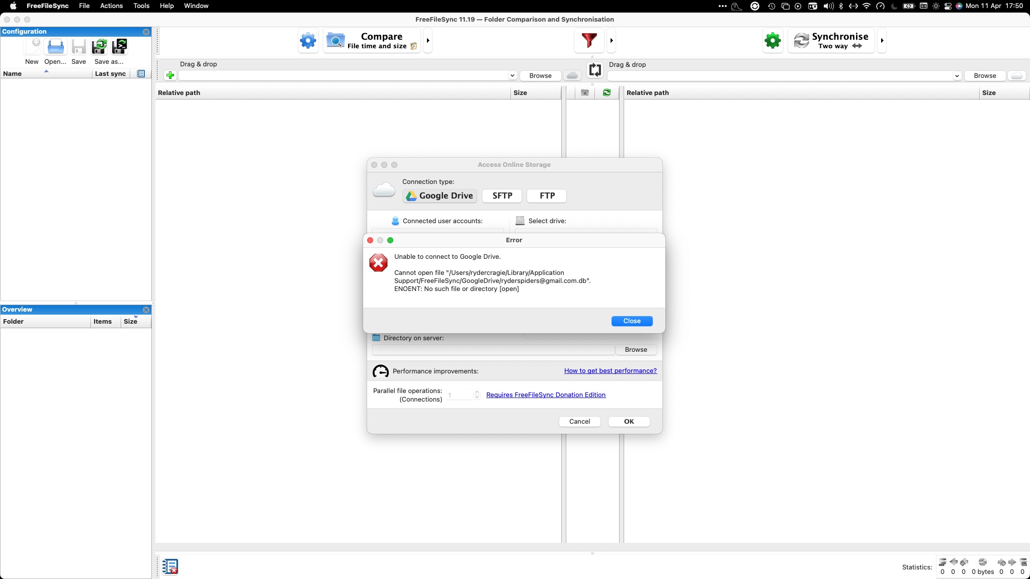

I can't even add the Google Drive connection in the beta app.

When you manually navigate to /Users/rydercragie/Library/Application Support/FreeFileSync/GoogleDrive via Finder, what do you see?
Posts: 23
Joined: 5 Apr 2022
Ryder Cragie
An empty folder.
Posts: 7535
The question is why isn't the ryderspiders@gmail.com.db inside this folder. You said you have already added this connection earlier and were successful syncing via GUI? After exitting the app, the .db file should have been created.

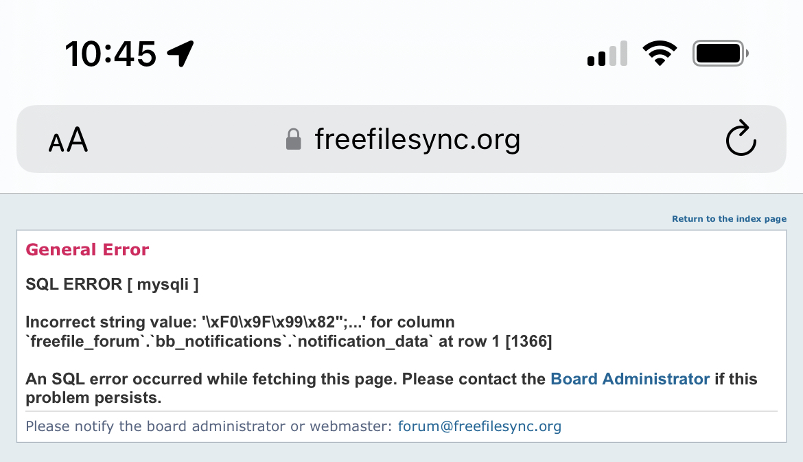

Posts: 23
Joined: 5 Apr 2022
Ryder Cragie
Just got this error on the forum as well.

Posts: 7535
Just got this error on the forum as well. Ryder Cragie, 12 Apr 2022, 09:46
Awesome, two forum bugs, one triggered by the emoji! :)
Awesome, two forum bugs, one triggered by the emoji! :) Zenju, 12 Apr 2022, 18:53
What's the other bug?

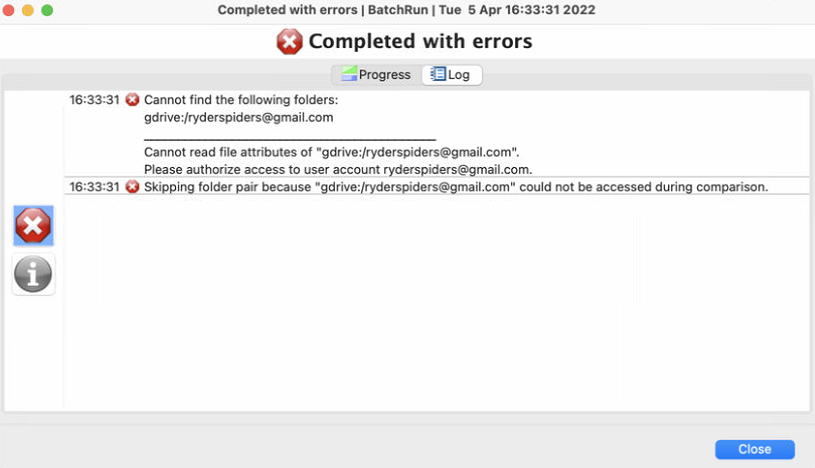

Now it's just asking me to login to Google every time I run the batch job and I keep getting this error:

Posts: 7535
Let's do one step at a time, no need to start a sync yet. What is the result of viewtopic.php?t=9268#p33625
Posts: 23
Joined: 5 Apr 2022
Ryder Cragie
Wait. It is syncing. I'll come back if there are any more issues. Thanks for helping.

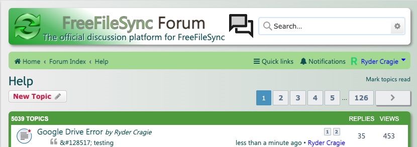

Emojis show as UTF codes on the main page as well.
Screenshot 2022-04-13 at 13.06.53.jpg (73.49 KiB) Viewed 2902 times

Posts: 7535
Emojis show as UTF codes on the main page as well. Ryder Cragie, 13 Apr 2022, 12:07
Indeed! Fixed! Thank you 🙂

You said there were 2 forum bugs. What’s the other one?
Posts: 7535
The fact that the error wasn't logged, but shown to the forum user instead (with a plea to contact the admin, which most users won't do anyway). Although this is phpBB default behavior, I'm still considering it a bug. (Also fixed now).
