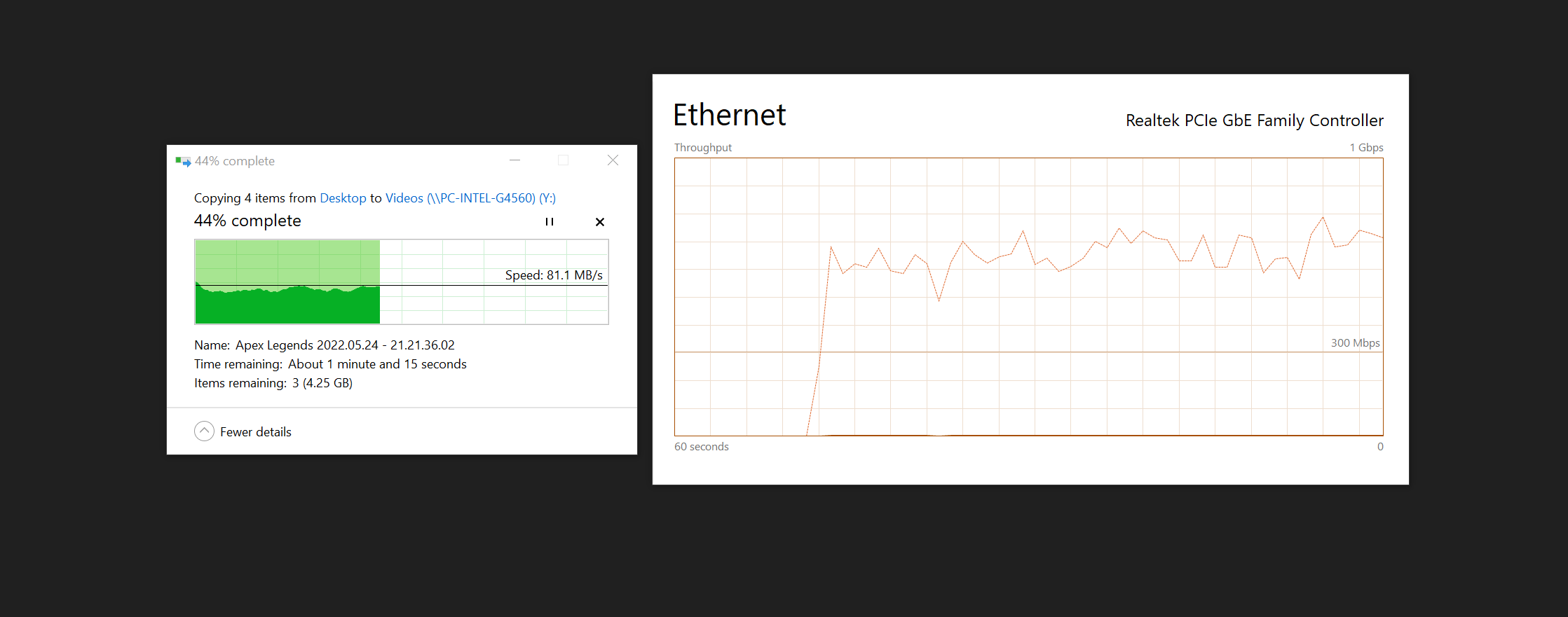

Hi guys, I found the solution after trying every youtube and blog solution. The problem was a fucking app I have installed on my PC's Netbalancer for monitoring and controlling network traffic, after disabling it I am getting 800Mbps on all my PC's. Thank u all for suggesting different solutions.
2022-06-15 15_53_54-Videos (__PC-INTEL-G4560) (Y_).png (56.37 KiB) Viewed 2404 times
