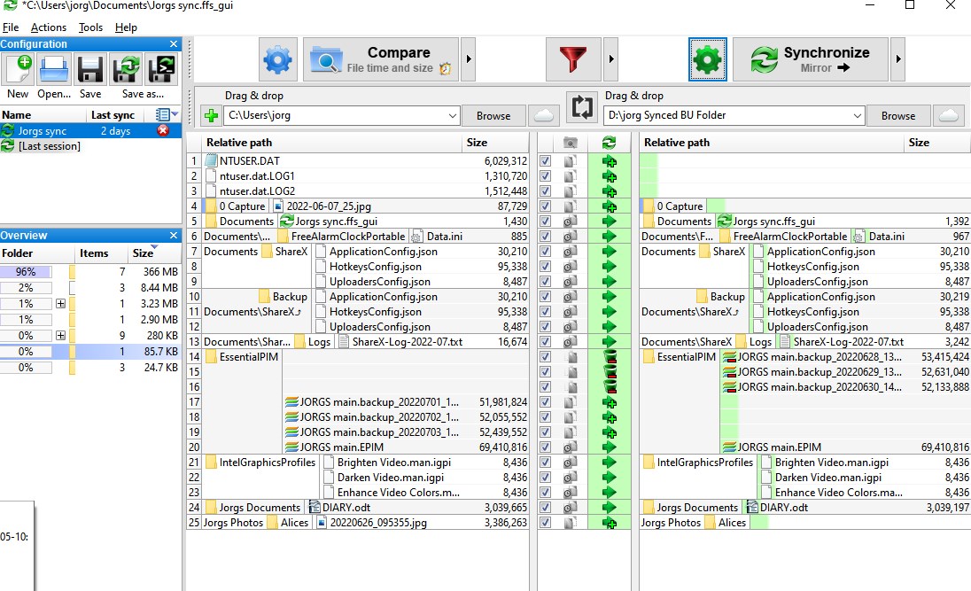

Okay... Can you attach a screenshot where FFS says that it is going to delete files? From your picture, FFS doesn't think it needs to delete anything on the destination at all. Or are you just deleting from the source and assuming it will delete on the destination? Attach a log if you can. Chances are you are using "update" instead of "mirror".

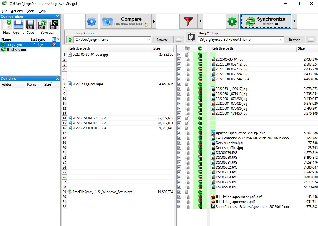

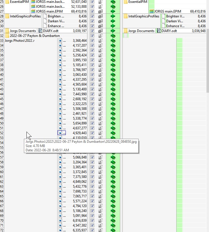

The first attachment is a shot backing up my files from left to right:
This includes my No. 1 Temp file (on which I had made a lot of changes), plus other files. As you can see it only deletes my EssentialPIM files which have changed and been deleted on the left - not any 1 Temp files.
Now in the second shot I only saved my No. 1 Temp files on the left, to the No. 1 Temp file on the right, excluding the other files, but have made no other changes.
(Screen shots may be reversed - not sure how to fix but I think you can figure out which is which)

Your pictures do not show any files existing only on the right-side that FFS does not intend to delete (your original issue).
Such files would be shown in the Compare results with a "minus" (do nothing) icon in between the left and right column. If not empty, you can make that category visible by clicking the corresponding icon mid-below the Compare results.
If that category is not empty, it seems you are not using the Mirror sync variant, but rather the Update sync variant (F8).
If you DO use the Mirror variant, and you do have files that exist only on the right and do not get deleted, by a sync, it seems you have excluded those files from your sync via the FFS Exclude Filter.

I am using the Mirror Sync as you can see on the upper right of both pictures.
And I have not excluded those files in either picture. I ran both with the exact same filters. FFS will find those photos to be deleted if I only pick that temporary file by itself. But if I include that same temporary file among other files (which need to be backed up) it doesn't.

I think I understand. Your second picture mirroring "C:\Users\Jorg\1 Temp" to "D:\BU\1 Temp" sees the pictures missing from the source and will delete them from the left. The FIRST picture mirroring "C:\Users\Jorg" to "D:\BU" does NOT see the pictures in the "1 Temp" folder at all.

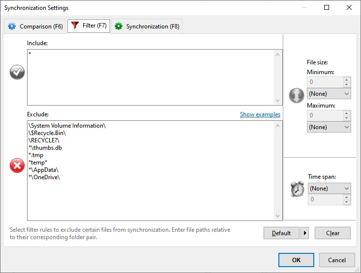

Post a screenshot of your filter settings
- Posts: 8
- Joined: 25 Jun 2022
Exactly!
(I've attached a screenshot of the filter.)
So any ideas of why?

- Posts: 4933
Bingo! The "*temp*" is the cause.
You'll have to make more specific filters.
In the full user folder sync, the "1 Temp" folder matches that filter, thus gets excluded

Makes sense.
Now I have to figure out why it worked when I selected that 1 Temp file by itself.
- Posts: 8
I just tried it and it works! I should have seen that.
Many thanks!
The Filters work on the content of the left and right base location, not on the left and right base location definitions themself.

so it will also not consider to delete any such files from your backup location. Plerry, 13 Jul 2022, 11:14
I tested this function before i used FFS and i was thinking that files and folders that excluded later will be removed. That´s what the trashcan say me in the mirror option.
Maybe my test was only files and folders that i add and removed (but not with exclude filters...) don´t know.
