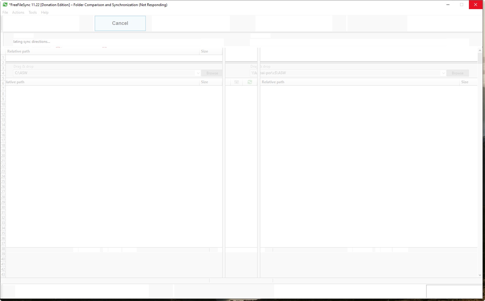

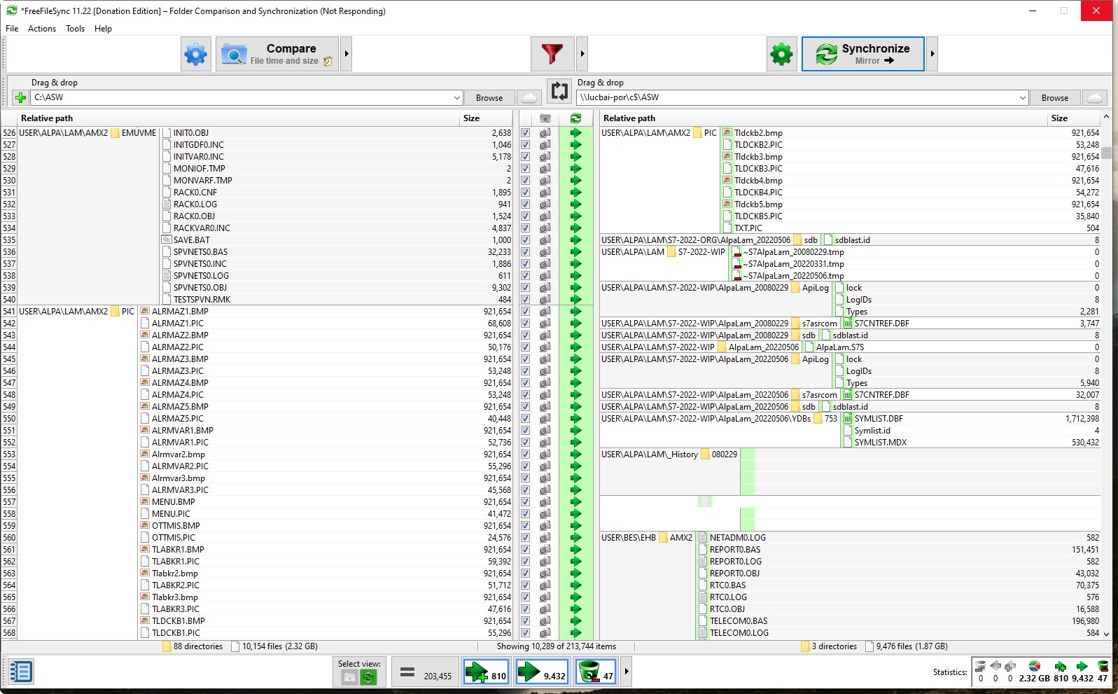

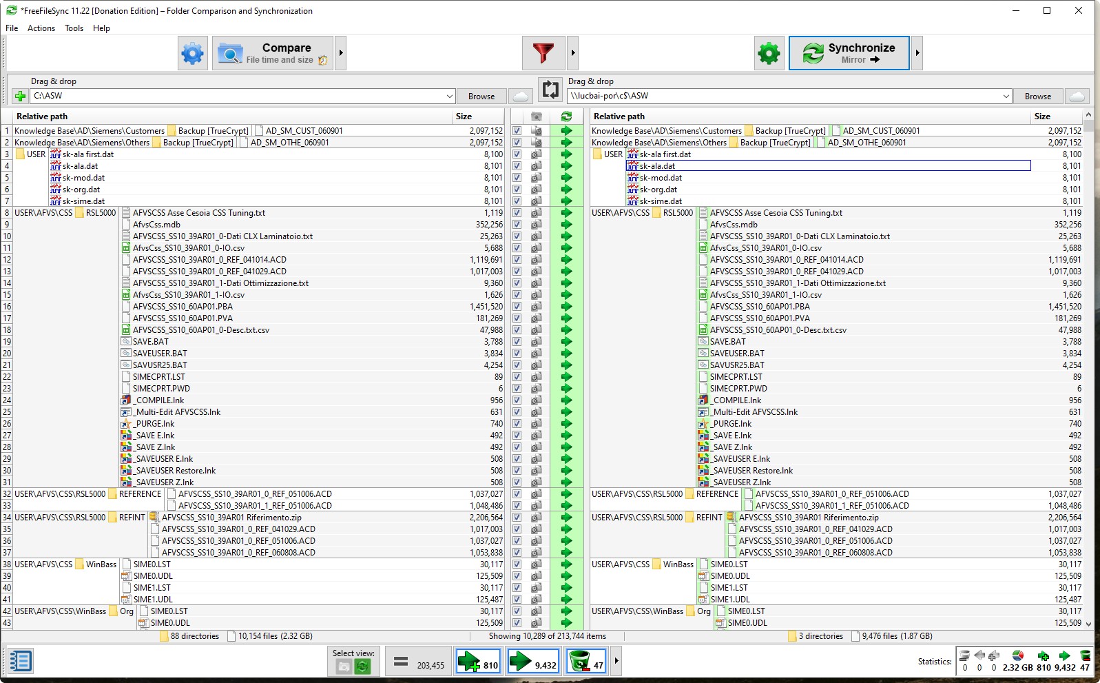

Hi, I just upgrade to v11.22 on Windows, never had a problem with past versions, but now it's not really behaving correctly...
My main common daily task (I do it several times per day for safety) is to maintain synchronized two "big" directories on two work computer I own (one desktop at office desk, one laptop when abroad, I'm the same administrator user logged on both computer on the same subnet):
Path 1 (local, on desktop): C:\ASW
Path 2 (network, on laptop): \\lucbai-por\c$\ASW
Everything worked perfectly until upgrade.
After a compare (before manual synchronize), this could be a result (fig.1): As you can see the compare is finished but a lot of files differ of one hour because of the well-known reasons (in fact I normally use the option "Ignore Time Shift" with value "1"). If you check fig.1, the compare has been done with "Ignore Time Shift" with value <blank> instead (this leads to a very large number of files that differ but they're actually identical...), because if I select "1" the compare *never* ends!!! FreeFileSync "freezes" as so (fig.2): and I have to force "Close the program" to exit (without synchronize obviously)!!!
More, even with "Ignore Time Shift" with value <blank>, when the compare ends (see again fig.1), if I try scrolling the windows with the right slider to see all files, after a while the program freezes again (fig.3):
To be short, it took me a lot of try and error tests and this is what I suppose about this problem:
- it depends on compare between a local and a network directories (local compares *seem* to work)
- it depends on very large number of "different" files
- it seems to depend on "Ignore Time Shift" value (if "1" it freezes before finishing the compare, if <blank> it freezes when you try scrolling a very large number of files)
- it seems not to depend on other options I tried to change (i.e.: Parallel file operation)
- it appears on both computer after upgrade (desktop and laptop)
- O.S. it isn't changed (Window 10 Professional 64-bit 21H1)
- I tried to delete configuration files and re-install program (both local and portable mode) without results
Really no-one else has/had this problem too?
Right now the program is really totally unusable, please tell me what could I try to solve this problem!
Thank you to all for any help,
Luca

Were you running 11.21 previously?
If you revert to 11.21, will that still work without freezing?
With 11.22, if you set up a new sync, same settings, but only a small subset of the files, or even an entirely different tree, will that complete successfully?
Maybe there is some sort of permissions issue & FFS is just trying to hammer away, getting nowhere?
And the issue need not be with "numbers", i.e., the number of files, but perhaps only a specific path?
The one shot mentions TrueCrypt. Is this a TC "drive", & might something there be playing in to what you're seeing?
