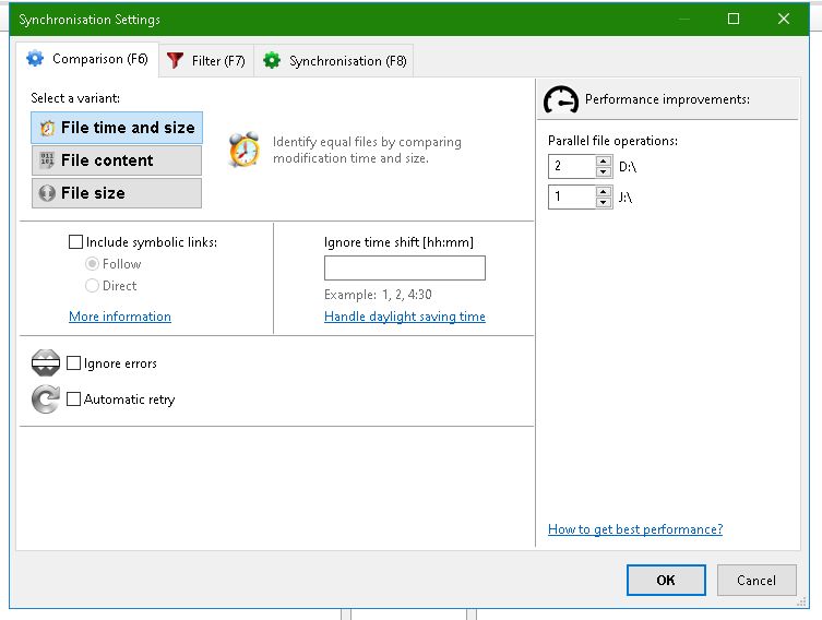

I only ever copy/synchronise from left to right with one HDD on the left one HDD as destination on the right. Does what I have sent you in the image take full advantage of the performance improvements that come with the donation edition ? Anything else to tweak for the sole purpose of speed ?

Parallel threads will not make that setup any faster, maybe even slower with mechanical HDDs

Not a very helpful answer. Try and be a little more proactive, please. Lots of emails back and forth just to understand what settings are required to get the Performance Improvements that come with the donation edition, unless you're saying that from hard disk to hard disk, there aren't any ?
Correct, hard disks crawl when attempting multiple operations on them
https://freefilesync.org/manual.php?topic=performance
"FreeFileSync can be set up to issue multiple file accesses in parallel. This speeds up synchronization times dramatically in cases where single I/O operations have significant latency (e.g. long response times on a slow network connection) or they cannot use the full bandwidth available (e.g. an FTP server enforcing a speed limit for each connection)."
Parallel threads would help a setup where you are syncing a single SSD as the source to multiple mechanical drives. The SSD can handle multiple transfers so having it sync more threads to different targets would speed it up

So what are the best settings to apply for source on the left and destination on the right. Changes on the left are updated to destination on the right. That's all I need to know. What settings to apply for maximum performance. Thank you
There is nothing you need to or can do to make it faster, besides upgrading the hardware itself.

So after all that, no Performance Improvements with the donated edition when copying A to B ?

Correct, you are limited by the speeds of your hardware currently
