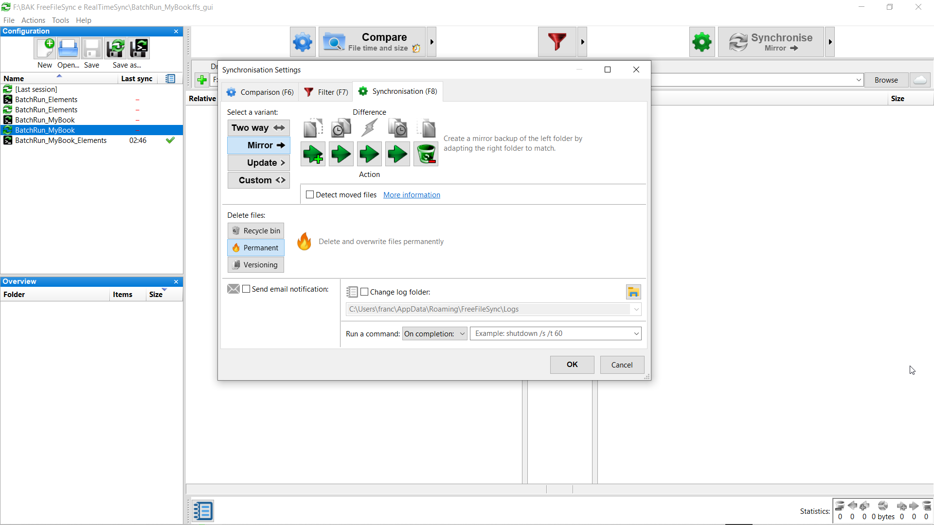

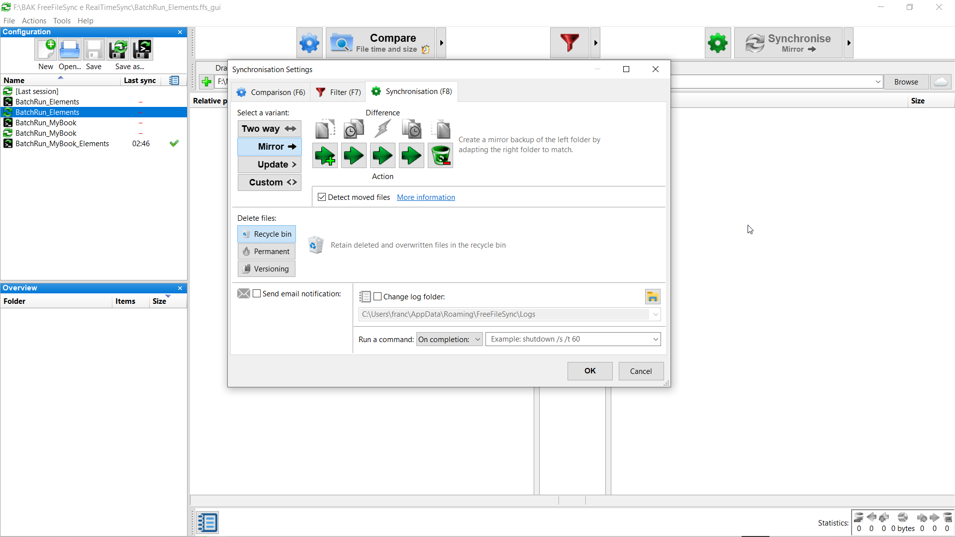

I have two external HDDs connect to a USB powered hub and then to my laptop and use RealTimeSync for sync to both HDD when there's a change to a specific folder (with sub-folders).
With 1 hdd, every change makes the old file to go to the Windows recycle bin, and with the other the file is permanently deleted. So, after creating both "profiles", than i created a batch job of both HDD/settings (screenshots attached).
Sometimes (many), my RealTimeSync doesn't stop updating even if there's nothing more to update. The only way to solve this is to stop it, reconnect both HDDs, or to restart the pc.
Anyone knows what may be causing this and how to solve?

What happens sometimes is that i change something in the directory monitored by FFS and then it stays constantly "working" like if changes were still being made.
I made a screen capture for showing you what is happening:

Yes, you're right but one of the external HDDs has a different configuration. While 1 reflects any changes made on F, the other does that to but sends the original files to Windows recycle bin as a safety feature in case i do something wrong (ex: delete by mistake).

Regarding the recycle bin, only the Elements has that configuration; My Book is set to delete or overwrite files permanently. And yes, when i change something that already exists, the "older" file on Elements is sent to the Windows Recycle Bin.
