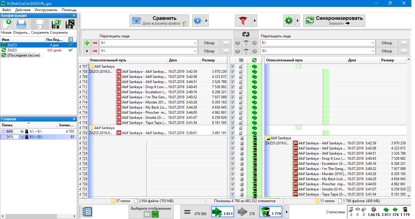

hello! in the last two versions of the program, files with similar names are not synchronized "Akif Sarıkaya - Drop It Low". I hope you can fix it. thank you in advance!
Posts: 4867
What do you mean?
Posts: 5
Joined: 20 Oct 2022
Jack1972
here. because of an unusual character in the artist's name, folders refuse to sync. but the files are exactly the same. the problem first appeared in version 11.25. before that, FileSync defined these files as the same. something changed when something was done with Unicode in version 11.25
Posts: 4867
That's interesting... Are you sure they aren't actually in different locations? What if you run the sync and then compare again, are the same files showing as different?

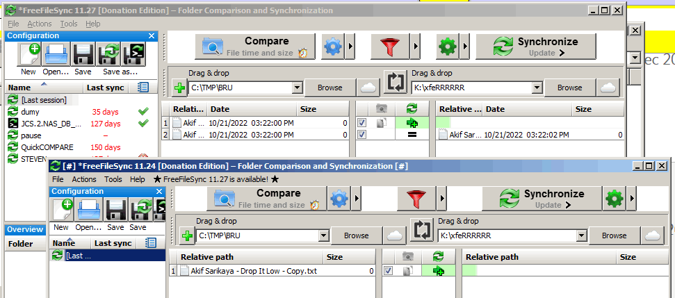

In the shot, only the file "Akif Sarıkaya - Drop It Low.txt" exists on K:.
Both the ı & i versions are in C:.
27 will want to copy the i version to K:
24 considers the two to be equal.
FreeFileSync - Diacritics 24 vs 27.png (33.12 KiB) Viewed 1199 times
So you're saying that in 11.24
Akif Sarıkaya - Drop It Low.txt compared equally to Akif Sarikaya - Drop It Low.txt ?
(Yes.)
And now in 11.27 they no longer do.
(Confirmed.)
Looking on the Everything (voidtools.com) end...
if you ignore diacritics, the two names match
& you take diacritics into consideration, then they are different.
