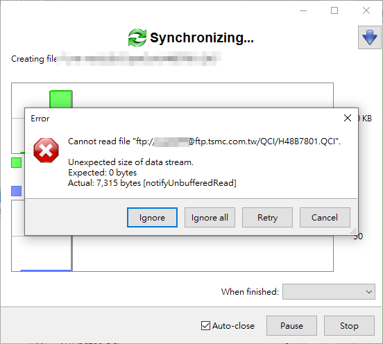

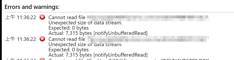

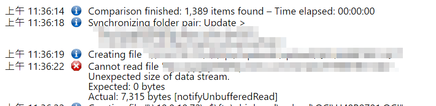

I try to FTP to sync to my FTP Server and I get an error message
My FFS version is 11.27
Need Help Thanks~
Image 004.png (30.16 KiB) Viewed 28415 times
Image 003.png (30.44 KiB) Viewed 28415 times
Posts: 7535
Which FTP server is this, and what is the real size of the file in question?

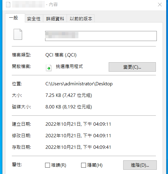

Hi
File Size 7.25KB

Posts: 7535
It looks like the file content was changed outside of FreeFileSync during the FTP file upload, thous the error message.

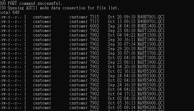

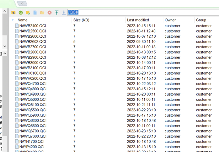

I tried using a different software to connect to the ftp server and the file is showing a different size than FFS, any good suggestions? thanks!
FFS File Size
截圖 2022-10-23 上午8.25.02.png (131.55 KiB) Viewed 28323 times
Dos Command
截圖 2022-10-23 上午8.26.13.png (290.27 KiB) Viewed 28358 times
Mobaxterm
截圖 2022-10-23 上午8.25.49.png (289.69 KiB) Viewed 28358 times

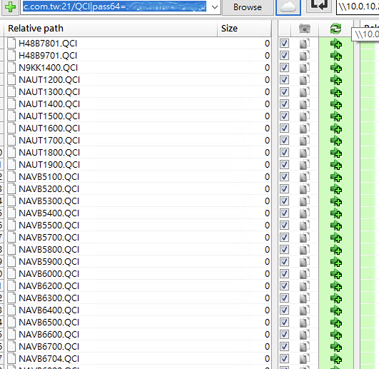

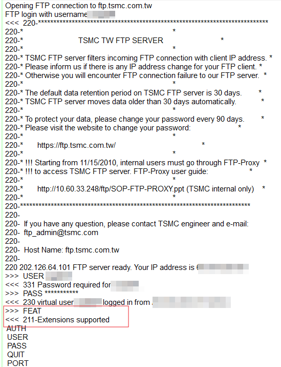

Posts: 7535
Okay, so you're in an FTP download case and FFS somehow gets an incorrect listing with file sizes of 0. How can that be?
What does the FTP server return to the "FEAT" response? (test e.g. with FileZilla)
Do you have a test access to this server that I could use for testing?
Posts: 12
Joined: 21 Oct 2022
dax
Hi
"FEAT" response as below and thanks!
Image 001.png (26.96 KiB) Viewed 28338 times
Image 002.png (9.08 KiB) Viewed 28338 times
Image 003.png (7.15 KiB) Viewed 28338 times

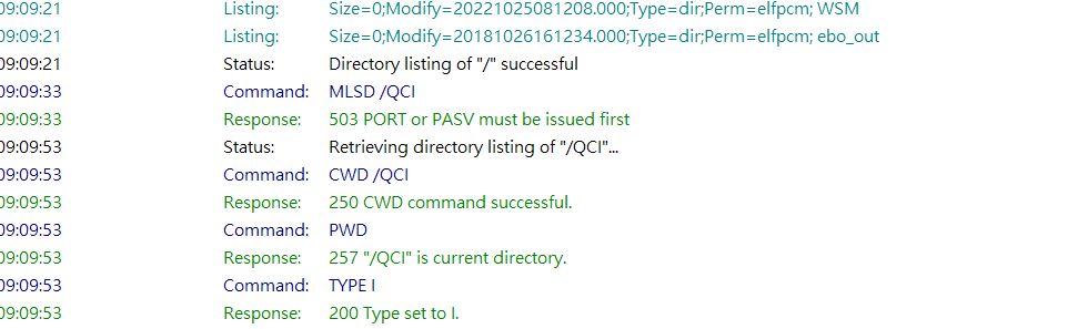

Posts: 12
Joined: 21 Oct 2022
dax
Hi
MLSD /QCI

Posts: 7535
Can you test the QCI directory listing with the following FreeFileSync version?
https://www.mediafire.com/file/tmwg8ap6s9l2r3y/FreeFileSync_11.28_%255BBeta%255D_Windows_Setup%25285%2529.exe
Posts: 12
Joined: 21 Oct 2022
dax
Hi
the problem is still the same

Posts: 7535
The FTP server is returning incorrect information for "Size" and "Modify". This seems to be a bug in the FTP server software with regards to the "MLSD" command.
According to your previous test the response should be:
For a test comparable to what FreeFileSync is doing you could enter MLSD followed by a path:
MLSD /QCI

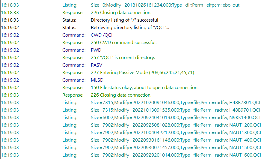

Posts: 12
Joined: 21 Oct 2022
dax
Hi FYI & Thanks!
Image 004.png (19.24 KiB) Viewed 28257 times

Posts: 7535
Enter "PASV", just as you did in viewtopic.php?t=9720&p=35793#p35751

Posts: 7535
=> FTP server bug: viewtopic.php?t=9720#p35759
