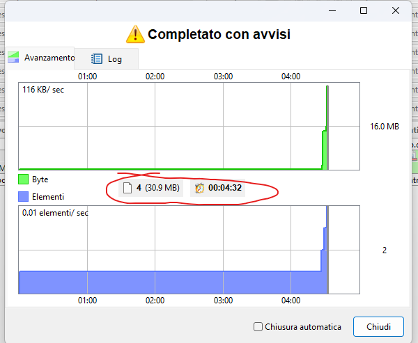

As you can see from the screenshot, 4 minutes to move 30MB of files (4 images).

The 30 MB image copying seemed to be going pretty fast. But what was FFS doing up to the 4 minute mark?

That's exactly what I'd like to know... I have no idea what it does when saving sync.ffs_db file.
In that case it stayed 4 minutes and 30 second on "saving mtp://.../sync.ffs_db" and then took 2 seconds to transfer files :(

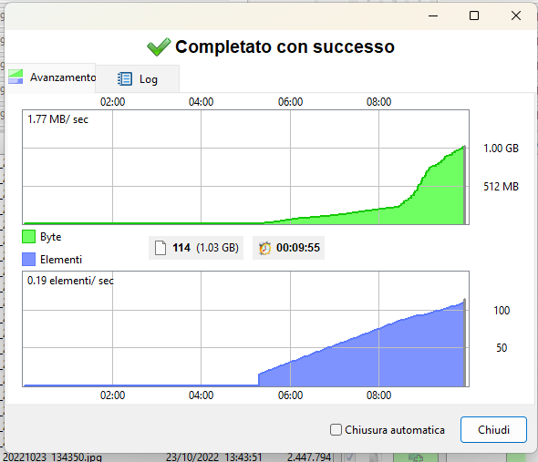

5 minutes of literally nothing
Then the process started (at riddiculous speed...and I got the donation edition wishing for speed improvements)
To end all the transfer in 10 minutes...
Ugly story =(
