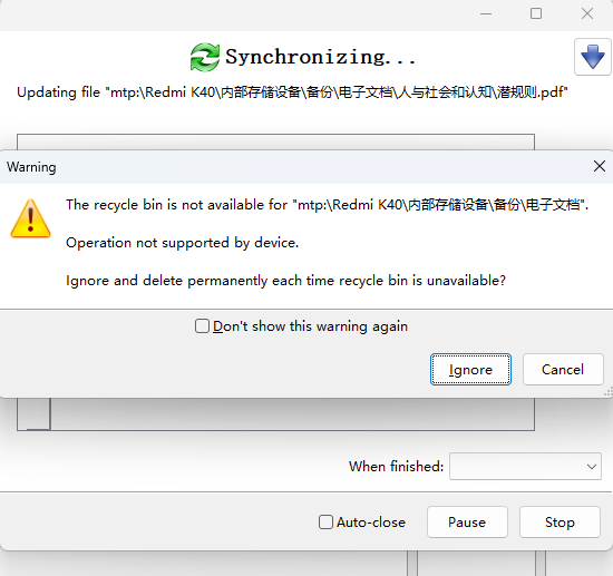

This device is not supported when Android 13 phones are synchronized
Posts: 8
Joined: 26 Dec 2022
wobaozi
The device does not support this operation when synchronizing files in FreeFileSync version 11.29.
Computer Windows11, MTP terminal Xiaomi mobile phone K40 miui13.

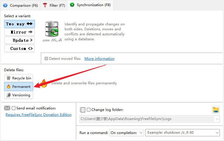

Change deletions to permanent in the sync settings
Posts: 8
Joined: 26 Dec 2022
wobaozi
Is it this one?[url]C:\Users\董少慧\Desktop\23年-01月-6日-0时-13分-54秒.png[/url]
Posts: 4911
That is correct!

No, this method doesn't work
Posts: 4911
No, this method doesn't work wobaozi, 08 Jan 2023, 14:00
It sure does, cause you can't get an error about the recycle bin not being accessible if it isn't trying to be accessed. Check your settings

I've tried turning on FreeFileSync repeatedly, and sometimes I can transfer some files. I also tried switching languages and it worked sometimes.I tried reinstalling, and also tried installing FreeFileSync on another PC, with the same result.

I've tried turning on FreeFileSync repeatedly, and sometimes I can transfer some files. I also tried switching languages and it worked sometimes.I tried reinstalling, and also tried installing FreeFileSync on another PC, with the same result.I am using a Redmi phone, the phone system is miui13-Android 12,
