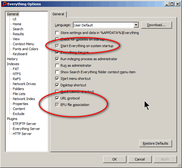

The screenshot contradicts your requirement:
should (always) allow setting changes
(regardless of how you're running the program, admin or not) therube, 26 Dec 2022, 16:33

- Posts: 1223
While it is grayed out, I can still change & Apply the setting.
With FFS, you'd want to be able to do that, regardless of running Admin or not.
(Otherwise, if you enabled that setting, as Admin, but were running as a regular user, you would not be able to uncheck it, without first restarting as Admin.)
- Posts: 7524
Donald Norman would hate that idea (and I agree.)While it is grayed out, I can still change & Apply the setting. therube, 26 Dec 2022, 17:03
