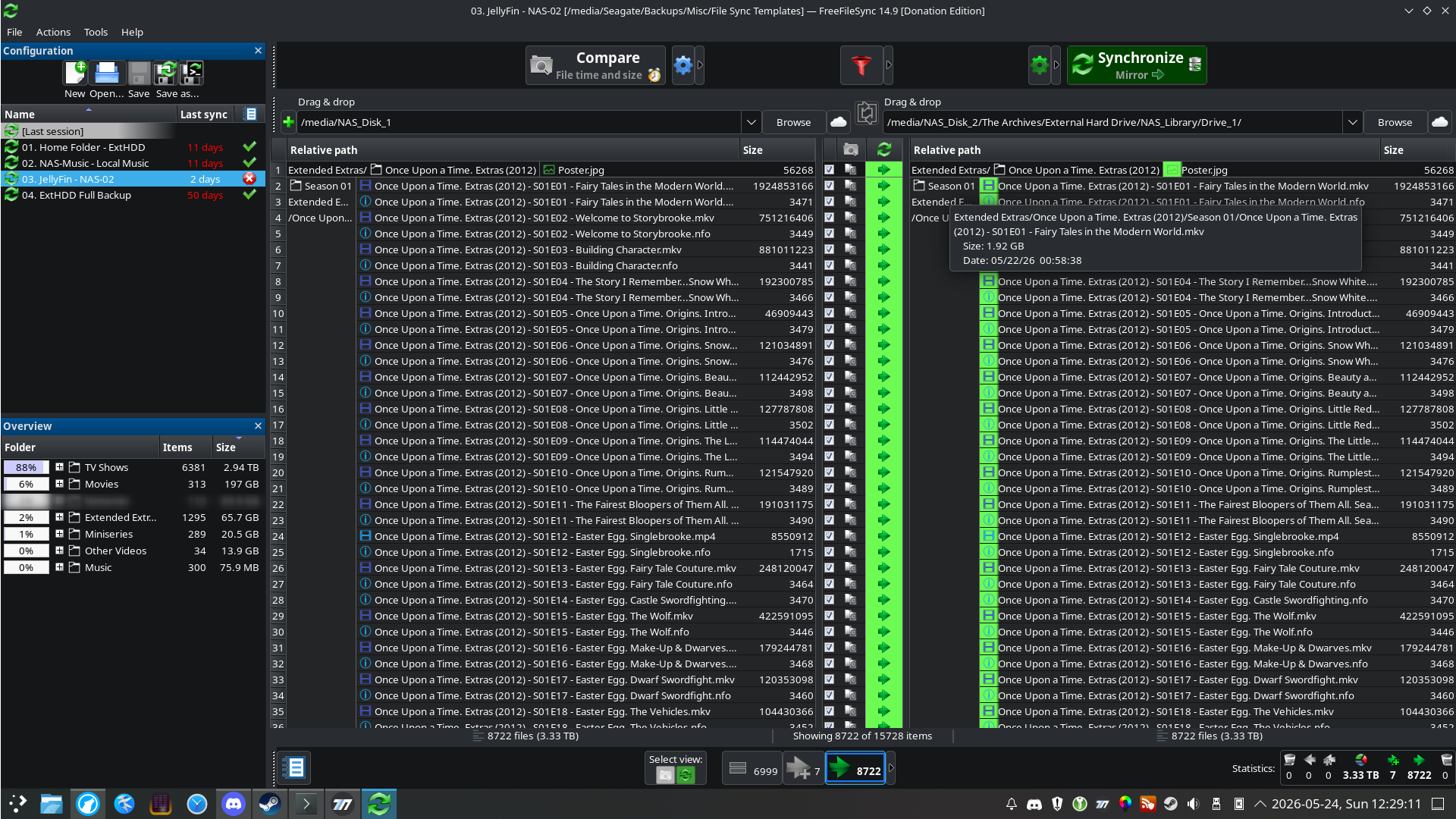

This is EXACTLY what is happening to me.
For example, to test this, just now I mirrored from Disk 1 to Disk 2 of my NAS the file `2001. A Space Odyssey (1968).mkv`, both files having a file size of 10.4 GiB and the latter's timestamp now 2026-04-08T01:55:16. (The latter's timestamp *is* supposed to be different from the former's, right? I know, stupid question. Of course it is. Sorry.)
I then hit Compare again and it once again shows up on the list.

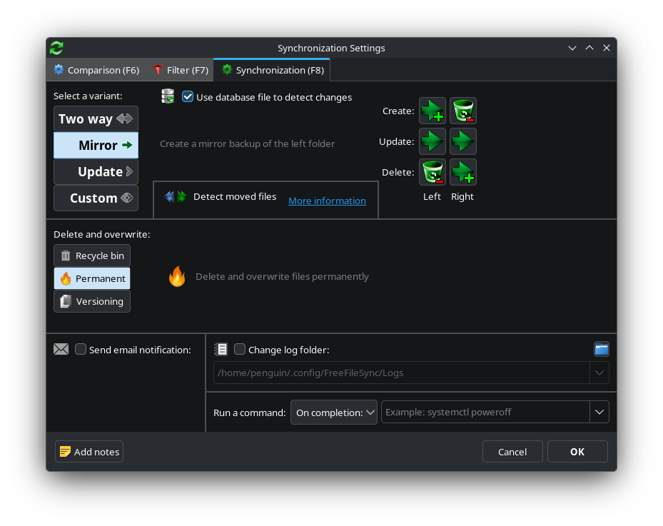

Here is my synchronization settings:Depending on your synchronization settings Plerry, 13 May 2026, 11:43

Oops, I accidentally used a temporary file hoster site. Here is actually my synchronization settings:
Also, for some reason, I can't seem to edit my comment (or whatever it's called), so I just wanted to correct myself: I have a QNAP NAS, and it is connected to my computer through SMB. (Not SMP.)

Okay, I just checked and yeah my QNAP is updated—the firmware as well as all apps. I then did a mirror sync and it said 3.33 TB was needed to be processed (4 new / 8722 updated). I did about 1 TB, then stopped the sync, and rescanned. It once again says I need to do 3.33 TB, or 4 new & 8722 to be updated.Make sure your QNAP is updated. I've seen timestamps mismatching caused by NAS firware/software. xCSxXenon, 21 May 2026, 14:05

It only does that when it's a file that needs to be added or deleted. I only have 7 files that are new; the other 8722 files I have are only files that need to be updated, and it doesn't say a reason.If you run a Compare and then hoover your mouse over the icon mid between any of the items, FFS tells you why it thinks it needs to take the proposed sync action. Plerry, 24 May 2026, 07:55

And as I said in reply to that comment, I'm connected via SMB. I also provided a screenshot of my synchronization setup above.Depending on the protocol and mounting method you use to connect to a resource, the timestamp of the left-side file can not be preserved when overwriting/updating your right-side file.
