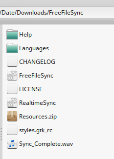

should...but it's not doing enything :(
I don't understand why ... I have extracted the FreeFileSync_7.9_Debian_8.3_64-bit.tar.gz
and nothing happens when I try to run FreeFileSync or RealTimeSync
and I don't know how to start them from terminal to find out why.

Thank you for the reply,
I have tried but it's the same from the archive
if you could describe how to run it from terminal, to find out why it's not running, it would help me so much.
I am still new at Linux commands.
Thank you again !
Thank you again !
