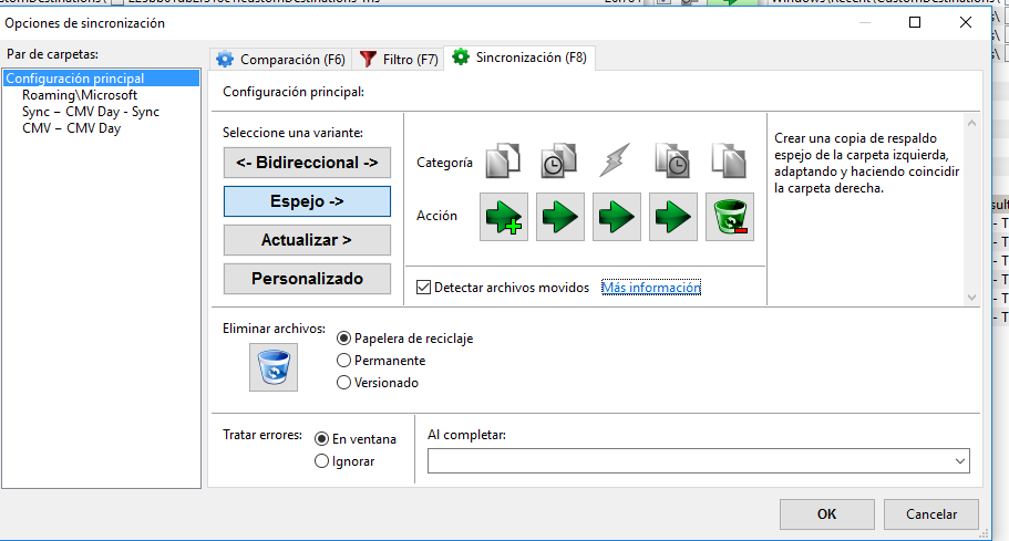

Here is my sync config:
In case it matters, I'm doing it as a batch process.

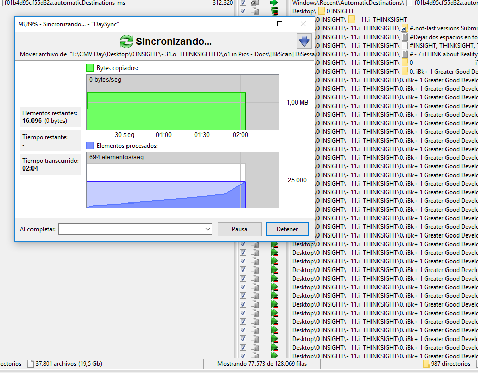

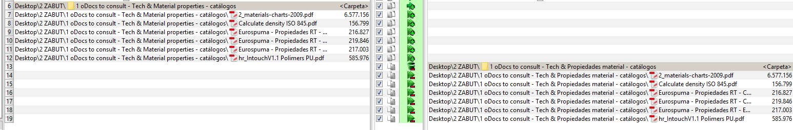

And here is an example of a Comparison after just one small folder renamed:

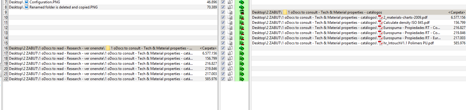

Same folder moved to another folder:

Move & rename instead of copying (Mirror w detect moved files already ticked...) ?

- Posts: 7567
Everything looks fine, the individual files are moved as expected.

In case the above images are misleading, I've just done a test renaming just two folders, but with several files inside. If FreeFile sync just renamed the folders, it would take it much less than one second, after the comparison, to execute the renaming. But the process takes minutes... (again I mean just syncing, comparison has been done before) See pic:
- Posts: 7567
No, folders are not moved, but the files contained. I believe there is some old thread here on the forum explaining this in more detail.

- Posts: 7567
I believe what you're seeing (on your screenshot) is a fast folder creation and many file moves, but no file copy + delete operations.Yet what I'm seeing when syncing is a slow copy and delete...
