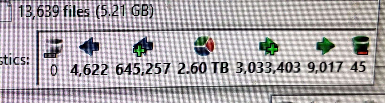

Then you didn't set it up correctly? If you don't set any conflicts to lead to deletion in custom settings, then it won't delete them like you are having a problem with. What do you even mean you can't see what FFS wants to 'delete', and you can only see something in the bottom-right corner? Take screenshots
- Posts: 17
- Joined: 5 Jul 2021
I don't mean to be rude, but if you don't know what's in the bottom right corner of the window of FFA, then that leaves me very concerned about the validity of your claimed assistance. Either way, this is what it looks like.
If you search me on the forum, you can see the amount of posts I have made and come to your own conclusion on my knowledge. I just wanted to see what it said down there if you aren't able to see it in the compare window. Is it the fact that there are millions of files being displayed in the compare window that you can't see them? Are you using the display filters at the bottom middle after running a compare? You can select/deselect those to only show files that are slated to deleted

Thank you to both of you. It turns out, though I can't nail it down entirely, sometimes it will show on the list of files (the files to be deleted) and sometimes it does not.
I do not see how clicking the green gear and going to custom resolves this.
Though it turns out the files it always wants to delete are already in the recycling bin, which, I don't get why its a default that it wants to delete them, as if I wanted them deleted, I'd delete them myself. Seems imposing. Also, it turns out the buttons on the bottom center of the screen showing which types of files to show me doesn't always show the "files to be deleted". I cannot determine why this is the case.
