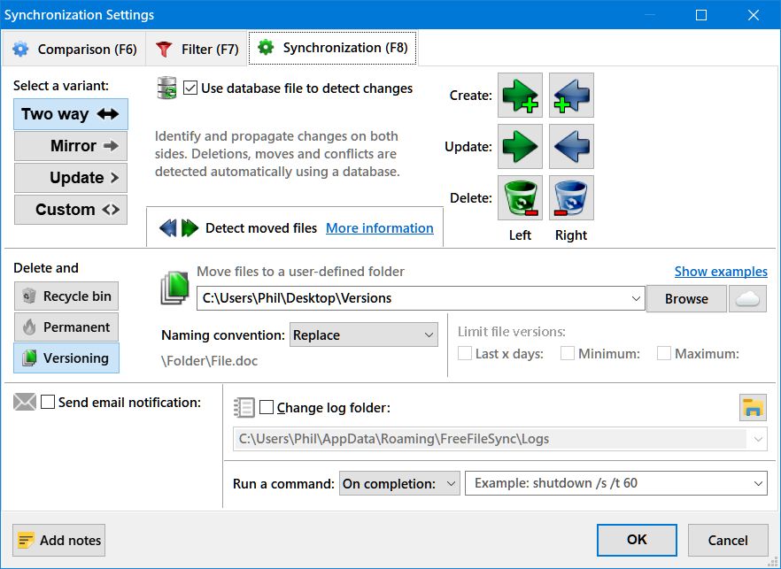

Thank you for your quick reply. On my Win10 machine, when I click the sync button, I see the image below.
I want to be able to save the last version on my Win10 machine, in case I make a mistake.
Am I able to do this and delete on my WinXP machine (I only have FreeFileSync actually installed on my Win10 machine)?

When I click on "Permanent", the versioning option disappears. I'm not sure how to delete on WinXP & keep the versions in C:\Users\Phil\Desktop\Versions. See attachment.
I'm sorry. Could you tell me what I'm missing?

If you select Permanent (instead of Versioning) there will obviously be no more Versioning.
Simply select Versioning and (if not retained) specify the desired Versioning location (in your case apparently C:\Users\Phil\Desktop\Versions on the machine you run FFS on, apparently your Win10 machine).
When using Versioning, any pre-existing files that will be deleted or overwritten by your sync, whether on your WinXP machine or your Win10 machine, will then be "moved"/copied to the specified Versioning location (in your case on your Win10 machine).

Thank you for your reply. However, that leaves me with the original problem that I mentioned in the first question. I want to keep versioning on my Win10 machine, so that if I make a mistake in updating a file, I still have the previous file in my version folder.
BUT, this means that I keep getting the warnings that the recycle bin on WinXP isn't available. I don't know if there's a solution that allows me to keep the previous version on my Win10 machine & avoids getting the warning messages.

I wonder if this is a bug then... If FFS is set to versioning, it shouldn't care about Recycle Bin access, but it sounds like FFS is throwing the error anyway. Is it really versioning and the warning is a false positive? Or is it not versioning the files deleted/overwritten on the remote machine?

Can you post a picture of your versioning settings? That warning looks like versioning isn't enabled

Sure, but it's enabled. It's the 3rd post above (9 Nov 2023, 21:06), where I responded to you.
The configuration you're showing on the screenshot is not the one you have set up to run via RealTimeSync.

Thank you! You're absolutely right. Of all my sync jobs, this was the only one NOT set up for versioning...it was set for recycle bin. I've now changed it & consider this solved.The configuration you're showing on the screenshot is not the one you have set up to run via RealTimeSync. Zenju, 13 Nov 2023, 19:17

I knew it was RTS because 1) I had it sent up that way, & 2) the sync icon was black (non RTS are green). So I just clicked on the icon in FFS, clicked on the filter icon at the top of the screen, & clicked on the synchronization tab. I saw that is was set for "Delete and Recycle bin". I changed that to "versioning" & the problem disappeared.
