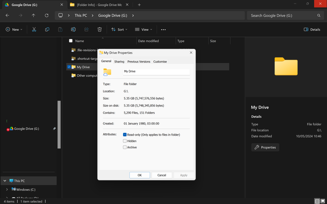

1. My bad, I concluded that sync.ffs_db and sync.ffs_lock were directly correlated (that they both contributed to file move/rename/delete detection, and that both warnings related to them are due to the same reason).
2.1. (G:\) is my Google Drive mounted to my Windows machine, BTW. (via Google Drive Desktop). Although it acts as a local drive, and by moving files to & from it, they would consequently be uploaded to/removed from Google Drive respectively. HOWEVER, you're right. Looking at the file attributes, it's partially read-only (despite my ability to move files from & to it, delete them, etc).
(Also, I run tasks manually, through FFS GUI, no automation involved).
So, it's probably missing the necessary write permission to write the files?
