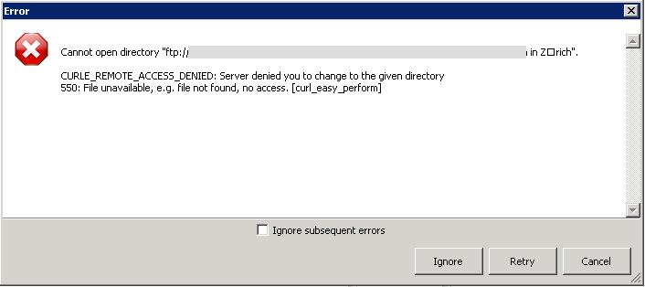

But during the first tryout syncing one server to another, I experienced two bugs. The first is encoding related error. A folder with in the name "zürich" could not be retrieved. It had something to do with the u umlaut, so I expect other special characters will also result in errors.

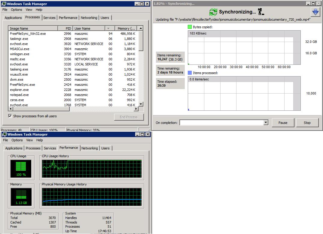

The second error was more difficult to overcome. During syncing, the process got itself stuck on a large file. The CPU rose to 100% and the transfer speed dropped to a dozen KB's per second.

I presume the problem is a non-compliant server that is not using the UTF8 encoding but rather some local ANSII encoding. Other FTP software simply chooses to not support such legacy servers. But maybe there is some way to detect the encoding? If yes, I could integrate it into FFS.But during the first tryout syncing one server to another, I experienced two bugs. The first is encoding related error. A folder with in the name "zürich" could not be retrieved. It had something to do with the u umlaut, so I expect other special characters will also result in errors. downloadgemist, 25 Apr 2017, 19:04

I also tested the folder transfer with filezilla, to see if it also choked on the "ü", but it did not (while running on the same windows server 2008). Maybe Filezilla reads more encodings.I presume the problem is a non-compliant server that is not using the UTF8 encoding but rather some local ANSII encoding. Other FTP software simply chooses to not support such legacy servers. But maybe there is some way to detect the encoding? If yes, I could integrate it into FFS. Zenju, 25 Apr 2017, 20:50
I do however not know if windows server 2008 does not support UTF8 encoding or not. Is there some way to check which encoding is set for an FTP transfer?
(character encodings are always a pain in the ass if you ask me :) )

Still strange enough so that it's worth to analyze. There should not be any "busy waiting", but it's possible it's originating from the FTP access layer (but it still should be fixed).I will create some dumps when the process slows down. However, it never completely hangs or crashes. It just goes from a solid transferspeed to a nihil transfer speed and high CPU usage. downloadgemist, 25 Apr 2017, 21:02

Just realizing: the problem with "ü" could also be due to this already fixed bug:
viewtopic.php?t=4292

Just finished setting up the testFTP (with temporary subfolders and files, all kind of stuff to work or not work). The new Beta did not do anything differently, still had problems with all the special characters. I also tested the beta on Windows 2008 as well on Windows 10. There was no difference.
Windows explorer itself and FileZilla both still read all the folders and files.

The character encoding issue has been fixed! The server is RFC-2640-non-compliant (UTF8 off by default), but there is a workaround that FFS now applies: http://www.mediafire.com/file/f8s51i8r9e95l8c/FreeFileSync_9.1_beta_Windows_Setup.exe

Thanks for the beta, but unfortunately the same problem with the accents: they are replaced to a character similar to a diamond.

I want to apologize. Preparing the "test login data" I realized that the problem is at our server with some file names with incorrect accents (they do not show correctly even in our linux server). FreeFileSync is working perfectly!!!
I am trying to figure out what the problem is. Programs like Filezilla can display and copy the correct accents even in the files that are not correctly displayed in the linux server. Any help will be appreciated.
