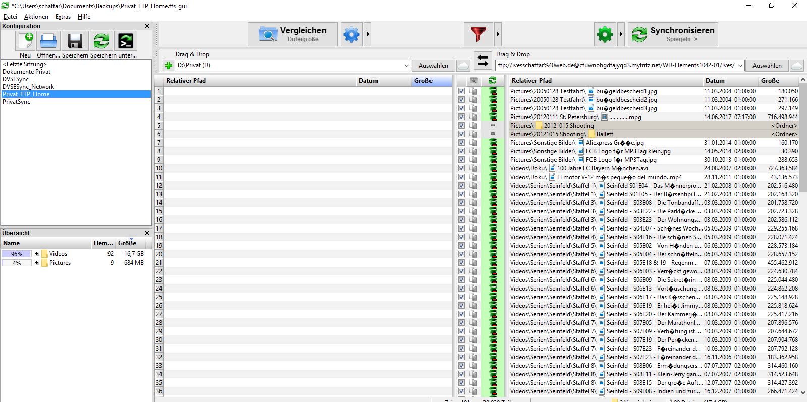

- Posts: 5
- Joined: 23 May 2017
Hi again, even with 9.2 the problem exists. I've added a picture to describe it. I had the same problem with FireFTP Plugin for Firefox, there I have changed from UTF-8 to windows-1252, but I can't find this opportunity in FreeFileSync.
- Unbenannt.JPG (294.69 KiB) Viewed 5484 times
- Posts: 7535
How can I reproduce the issue on my end?
- Posts: 5
I have files with ü,ö, or ä in their names (e.g. "Tür.jpg") stored on my pc. The same files are on my backup device at home. I connect via ftp to my backup at home. While comparing the files, the "error" on the screenshot appears. Comparing from PC to some extarnal USB device does not cause this error.

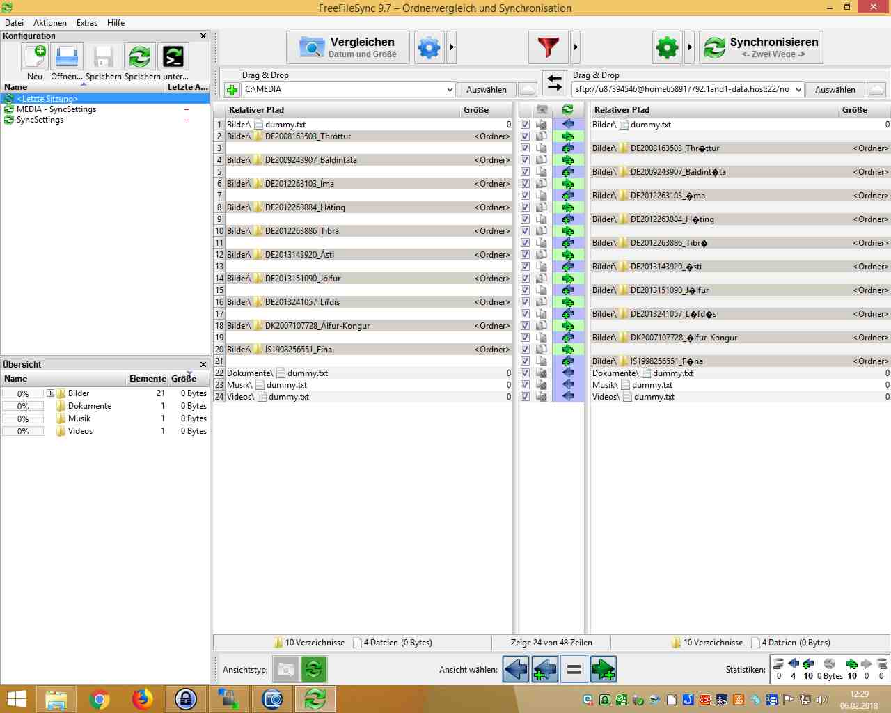

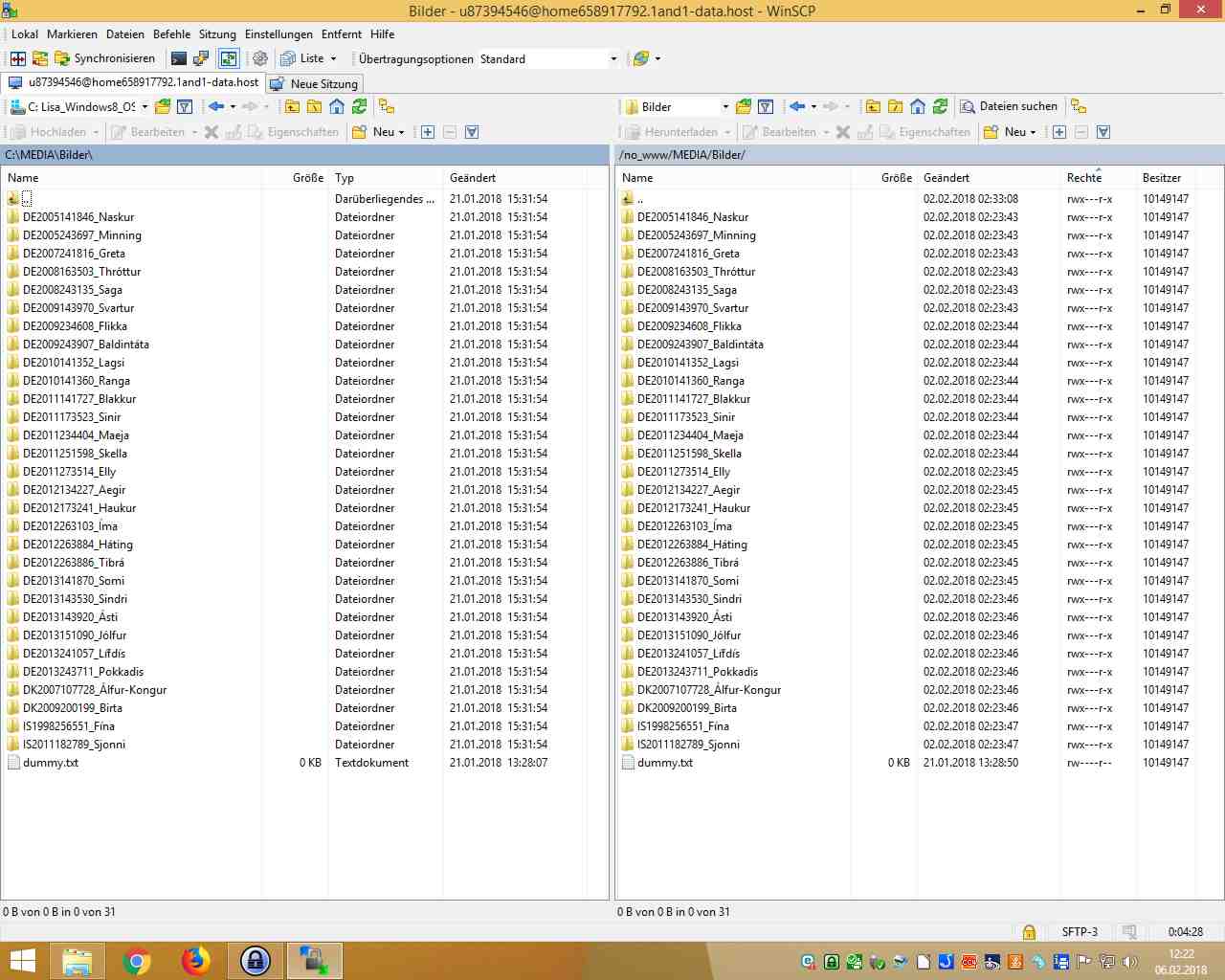

... my problems are not "German Umlauts" but icelandic chars on my webserver...
I have uploaded several folders containing icelandic chars to my webserver. There is no problem to sync them with winSCP, but if I try to sync them with FreeFileSync there are problems with icelandic chars.
- winSCP.jpg (119.99 KiB) Viewed 4991 times
- FreeFileSync.jpg (86.8 KiB) Viewed 4991 times
- Posts: 7535
This looks like an issue with your SFTP server not using UTF8.... my problems are not "German Umlauts" but icelandic chars on my webserver...
I have uploaded several folders containing icelandic chars to my webserver. There is no problem to sync them with winSCP, but if I try to sync them with FreeFileSync there are problems with icelandic chars. stvis, 06 Feb 2018, 11:37

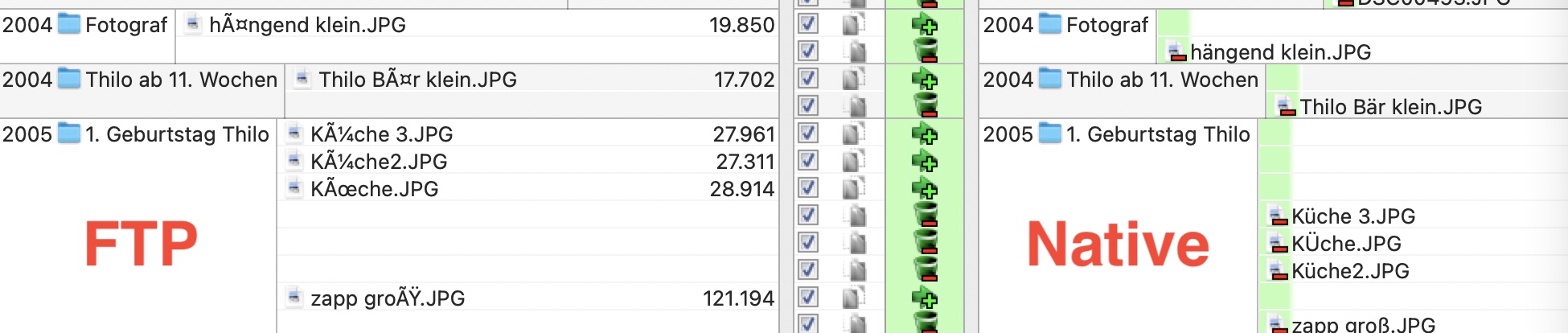

- Joined: 9 Mar 2021
I am having the same issue with "Umlaute" and the FTP connection (here on MacOS 11, running on Apple M1, FreeFileSync 11.8 Donation Edition). Umlaute are shown messed up over FTP connections. On the native Filesystem Umlaute are shown correctly. Running this job would totally mess up my backup.
See screenshot.
Thanks for your support!
See screenshot.
- Screenshot 2021-03-09 at 11.27.25.jpg (180.74 KiB) Viewed 2456 times
- Posts: 7535
The problem is the FTP server fails to report that it supports the UTF8 encoding (although it does according to the screenshot), so FFS has to (incorrectly) assume it is using ANSI.Hello,
I am having the same issue with "Umlaute" and the FTP connection (here on MacOS 11, running on Apple M1, FreeFileSync 11.8 Donation Edition). Umlaute are shown messed up over FTP connections. On the native Filesystem Umlaute are shown correctly. Running this job would totally mess up my backup. phzfn, 09 Mar 2021, 10:29
This is a server configuration bug: if an (RFC2640-compliant) FTP server supports UTF8, it needs to return "UTF8" as part of the FEAT repsponse. You can check this manually, e.g. via FileZilla.
