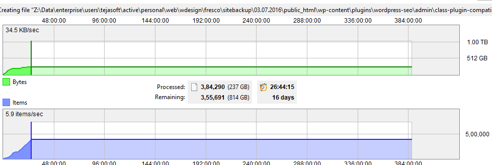

FileSync of the small files is taking too much time days and weeks, it would be nice of filesync support taking multiple small files at run time and compress them and transfer to the backup drive and unzip. This way i am sure it can save huge time.
Exactly like how HTTP support compression to reduce network bandwidth needs https://developer.mozilla.org/en-US/docs/Web/HTTP/Compression
Smart Accelerate with Runtime Compression
