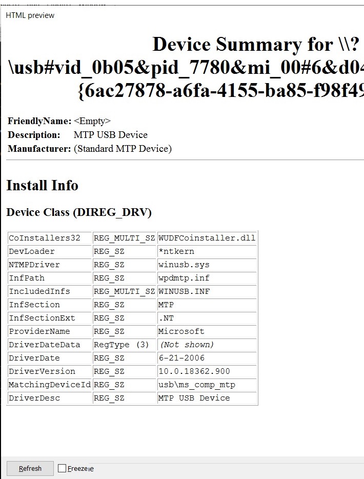

.....is..... that the "FriendlyName" of my ASUS phone is BLANK...
This, I found in "Device Summary" for my phone when I ran the "wpddeviceinspector.exe" tool.
And I think that this is the reason why FFS is unable to work with my phone.

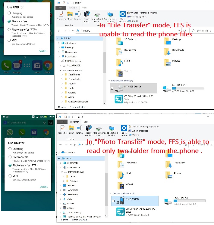

. Now ..... the problem in Detail
When I connect my phone to PC via USB Cable, it shows four modes viz : Charging, File Transfer, Photo Transfer, MIDI . ; And I generally use "File Transfer" mode for copying files to PC or to a pen drive
My Phone Info : Asus Zenfone Max ZC550KL

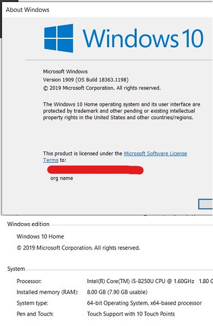

My Computer OS Info : Win 10 Home Version 1909 (OS Build 18363.1198)
My Computer Details : 1.6 GHz i5 Processor, 8GB RAM

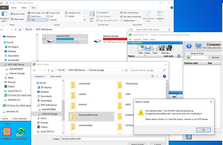

Steps I do ("File Transfer" mode in my AUSU phone):
1. Connect my ASUS Smartphone to the PC via USB cable
2. Select "File Transfer" mode on phone
3. Open FFS on PC and use browse button to browse the phone contents .
4. The phone displays many folders .
5. I navigate and select the desired folder in the phone

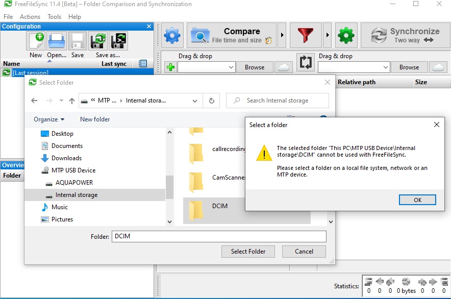

BUT ..... HERE THE PROBLEM APPEARS !!
I GET THIS ERROR :
The selected folder "xyz\xyz\xyz" cannot be used with FreeFileSync.
Please select a folder on a local file system, network or an MTP device.
mtp:\MTP USB Device\Internal storage\DCIM
File Path :: When I use "File Transfer" mode on my phone:
The path in explorer is this : This PC\MTP USB Device\Internal storage\DCIM
The path in FFS is shown as : unable to see because it gives error
How many times I close & reopen before I try again, I can't get FFS to work.
Steps I do again ("Photo Transfer" mode in my AUSU phone):
2. Select "Photo Transfer" mode on phone
4. The phone displays ONLY TWO folders - DCIM & PICTURES - is) .
6. Here FFS gives no error and I can continue copying these folder to my pen-drive .
File Path : When I use "Photo Transfer" mode on my phone:
The path in explorer is shown as : This PC\ASUS_Z010D\Internal storage\DCIM
The path in FFS is shown as : mtp:\ASUS_Z010D\Internal storage\DCIM

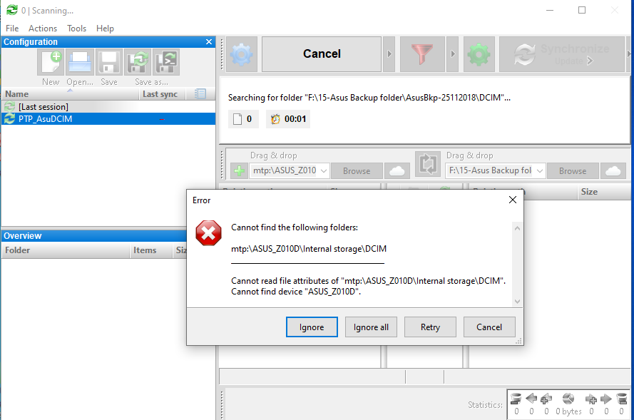

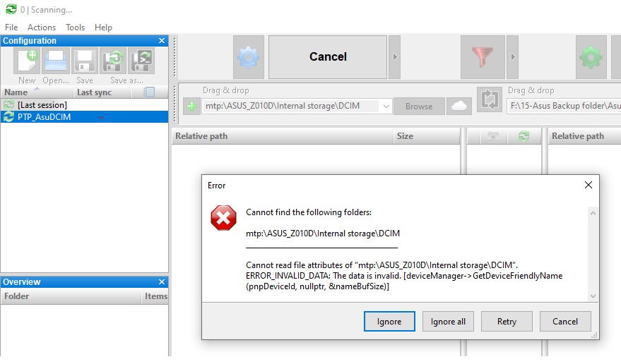

NOTE : I saved this ffs_gui file while in "Photo Mode" mode ; and tried using it in the "File Transfer"
mode but it gave error .
Cannot read file attributes "mtp:\ASUS_Z010D\Internal storage\DCIM".
ERROR_INVALID_DATA: The data is invalid. [deviceManager->GetDeviceFriendlyName
(pnpDeviceId, nullptr, &nameBufSize)]

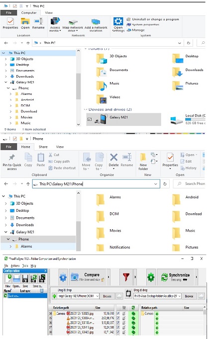

FFS worked successfully with my old phone & my friends new phone :
#1. My old Phone - Intex Aqua Power with Android 4.4.2 .
#2. My friend's phone - Samsung M21 with Android 10.
File Path with Intex Phone : When I try with a relative's phone :
The path in explorer is this : This PC\Aqua_Power\Phone storage\DCIM
The path in FFS is shown as : mtp:\Aqua_Power\Phone storage\DCIM
File Path with Galaxy M21 : When I try with a relative's phone :
The path in explorer is this : This PC\Galaxy M21\Phone
The path in FFS is shown as : mtp:\Galaxy M21\Phone

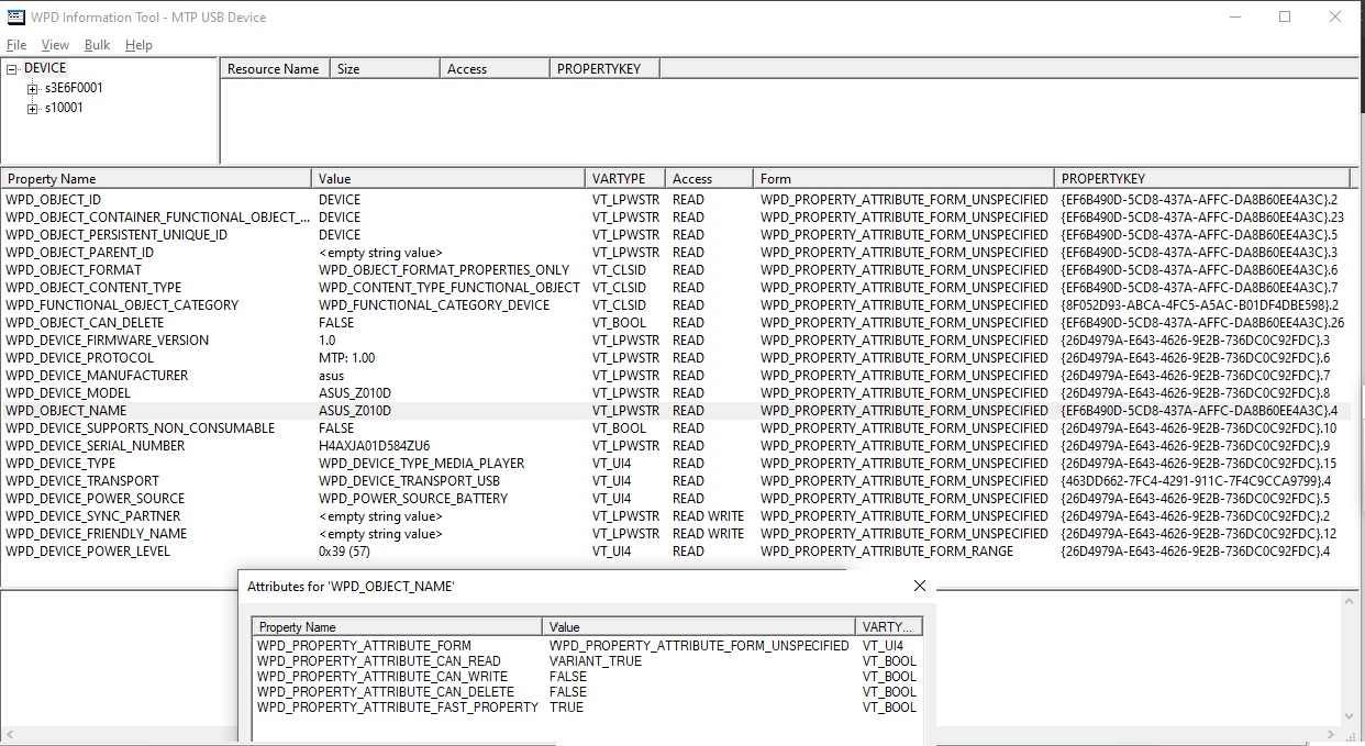

Image 00 : Device FriendlyName is blank : 00-FFS_NOT-OK_FriendlyName_ASUS_Z010D.jpg
Image 01 : my PC and OS configuration : 01-PC_OS_Config.jpg
Image 02 : 02-FFS_NOT-OK_with_ASUS_Z010D.jpg : FFS not working with my Phone ASUS_Z010D
Image 03 : 03-FFS_PT-FT_mode_ASUS_Z010D.jpg : Connecting my phone ASUS_Z010D using "Photo Transfer" & "File Transfer" Modes to the PC
Image 04 : 04-FFS_gui_file_error_with_ASUS_Z010D.jpg : Error while using PTP Mode generated ffs_gui script in the FT Mode
Image 05 : 05-FFS_OK_with_Galaxy_M21.jpg : FFS works OK with Galaxy M21 phone

but FFS works fine with Galaxy M21 phone without any problems.

Thank you for the beta version.....
but... it too is giving the same error : "The selected folder cannot be used with FreeFileSync.
ffs Beta 11.4 too giving error &quot;The selected folder cannot be used with FreeFileSync&quot;
ffs Beta 11.4 too giving error "The selected folder cannot be used with FreeFileSync"

Posts: 7523
Okay, internally, there's no error anymore, the device just isn't found.
Can you open wpdinfo.exe for the "MTP USB Device" directly on the root device item and look what info is shown there, WPD_OBJECT_NAME in particular?
Posts: 7
Joined: 25 Nov 2020
LamaDevi
Yes !!
here it is !

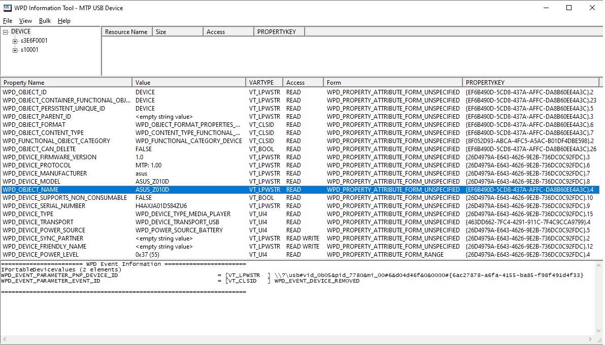

01-ffs_ASUS_Phone_WPD_OBJECT_NAME.jpg :
When ASUS Phone is Connected it displays no information in the lower plane.
02-ffs_ASUS_Phone_WPD_OBJECT_NAME_disconnected.jpg :
When ASUS Phone is dis-Connected , it displays some information in the lower plane.

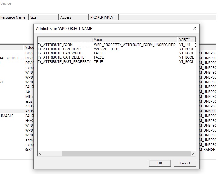

NOTE (if useful) :
The "Attributes Window" is not stretchable .
So the user can't capture the full details in a single screenshot (my screen resolution is 1280x720).
The attributes window is not stretchable
When ASUS Phone is dis-Connected (after MTP connection)
Posts: 7523
Interesting: It seems Explorer does not fall back to WPD_OBJECT_NAME when friendly name is missing, as suggested on Microsoft's MSDN, but to device description instead (even though it's a bad choice: uses "MTP USB Device" instead of WPD_OBJECT_NAME = "ASUS_Z010D").
Here's the fixed(?) version: https://www.mediafire.com/file/zap5fzcptyawd28/FreeFileSync_11.4_%255BBeta%255D_Windows_Setup%25284%2529.exe

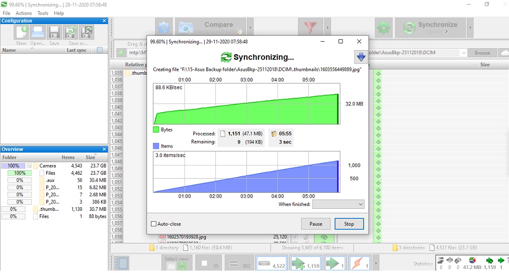

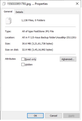

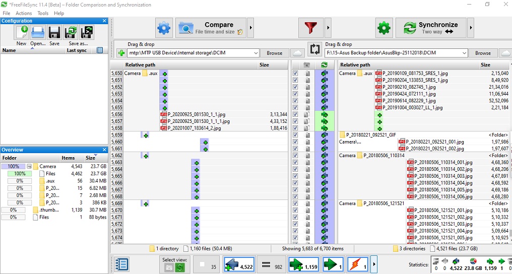

One small observation :
#1. The fist time I ran FFS with a ffs_gui script and I noted that there was a little visible delay while the ffs searched the folders for the fist time and I could see the message with time displayed for 10 or 11 sec . ....but no screenshot taken...
#2. I also observed that it took around 6 minutes of time to sync a folder from phone to to the external backup drive .
It was DCIM folder contained few new fewer pics & ".thumbnails" folder (containing of about 30 Mb & 1100 thumbnails) from phone ; total new data of DCIM folder to backup/sync was about 47 Mb.
Pics were few because I regularly deleted numerous pics on phone itself that I didn't like while thumbnails were untouched.
Are the above 2 behaviors normal ? ... or the delay happened because it was beta version and you had put additional checks for correct functioning ?
One Dumb Question : If a bug at Microsoft caused this , you can submit this 'Bug Report' to Microsoft ..... If they have a bounty for such bugs , they may assign it to you .
Hurray_ffs_114_worked.mp4
(344.11 KiB) Downloaded 112 times
Posts: 4911
That is fairly normal timing for mtp connections. I would advise excluding the thumbnails folder using a filter, as that large number of small files is eating up a lot of the time for no real benefit. It is generated so your phone's Gallery/Photos app can display the thumbnails, but not used on a computer anyway.

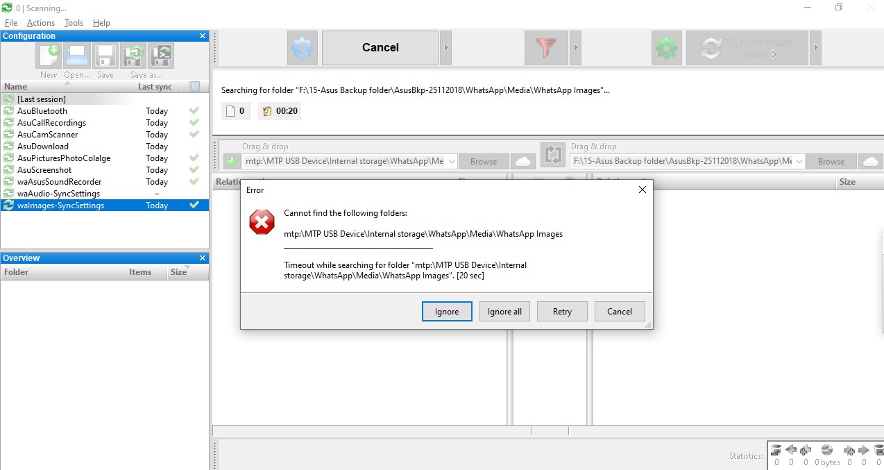

Just to upadate/inform ......
I downloaded the latest 11.4 version of FFS and EVERYTHING IS WORKING SMOOTH.
I modified an ffs script (of the old Intex phone) to suite my ASUS phone.
They worked nicely ....
Many thanks again for this nice app.
...BUT ...... Only once did I face this error while I was trying to sync the *"WhatsApp Images folder"* to my backup.
Timeout while searching for folder
Cannot find the following folders:
mtp:\MTP USB Device\Internal storage\WhatsApp\Media\WhatsApp Images
Timeout while searching for folder "mtp:\MTP USB Device\Internal storage\WhatsApp\Media\WhatsApp Images". [20 sec]
I closed the App and I re-ran the same script, and the error didn't appear.
Did the app give this timeout error as 20 seconds was not enough to search/scan through the lots of images on phone ?
