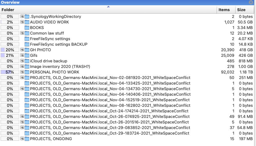

Hello, I don't know enough of how to respond properly, i'll do my best, please bear with me.
I know more than one of these ENOENT instances, have happened when I have changed a folder location, but I do not know how to solve the problem. i.e. what is the correct protocol for changing a folder location or renaming so FFS understands where it is.
Many whitespaceconflict folders have been generated.
I appreciate your response or any suggestion as to articles to read. I have read the instructions of the software as someone else suggested, but I am sure I do not understand as much as I'd like to.
I am including a screenshot of the Overview.
Thank you.
Thank you.
