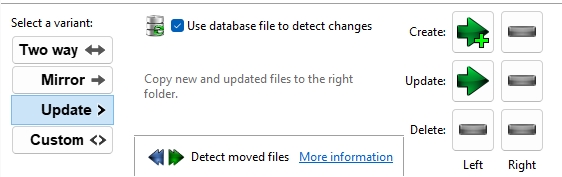

im a bit ocnfused as i thought this was the can but now in 13.1 I see a rubbish bin icon in the bottom of the comparison window and even when I turn that toff I still see files listed for deletion when I hit the sync button.. this is worrying. I'm afraid to actually do the sync..

Nope definitely using UPDATEYou must be using "mirror" sync option xCSxXenon, 09 Jan 2024, 16:43

then what are these rubbish bins doing here??You are mistaken somewhere then. It is impossible to have any items marked for deletion when using the UPDATE variant.Nope definitely using UPDATE drxian, 10 Jan 2024, 09:08You must be using "mirror" sync option xCSxXenon, 09 Jan 2024, 16:43

- Posts: 4911
On the current version of FFS, changing any options/action from the default 'update' configuration will change it to a custom config automatically. I don't know what is wrong with your setup. I would like to see a screenshot of the line items that are listed as "delete from left side" actions.then what are these rubbish bins doing here?? drxian, 11 Jan 2024, 14:34You are mistaken somewhere then. It is impossible to have any items marked for deletion when using the UPDATE variant.
2024-01-10 11_28_17-Synchronization Settings.jpg xCSxXenon, 10 Jan 2024, 16:31
Edit: The only way I was able to replicate that behavior was to run a comparison and then manually select files and mark them to be deleted from the left side. Make sure you aren't somehow manipulating to actions after the compare runs
