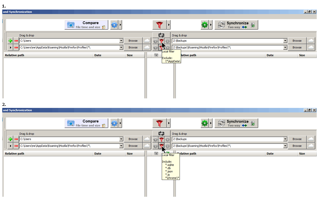

See if something along these lines does it with local includes/excludes for each folder pair.
(Now, I don't know if my particular paths/includes/excludes are correct necessarily, but the idea probably is).
FFS - multiple pairs with separate in-excludes for each.png (28.2 KiB) Viewed 494 times
FFS - multiple pairs with separate in-excludes for each.png therube, 03 Sep 2025, 14:55
Thank you for the screen shot. I never realized that the funnel appeared between the folder pairs until I saw that. I was also lost on the Global/local settings. The sad thing about your screen shot is I cant make it larger to see your filters.

Posts: 1239
Joined: 8 May 2006
therube
Open image in new tab (or whatever your browser may offer), should allow you to see it bigger, enlarge it...

I see that screenshot - now "folder pairs" is obvious. and I presume the funnel icon is the button to show a local" rule
I had missed the tiny little green plus sign on the left to add another set of files to sync.
The funnel icon for local does not appear until you add a second pair of folders.
That is the piece of information I needed!
