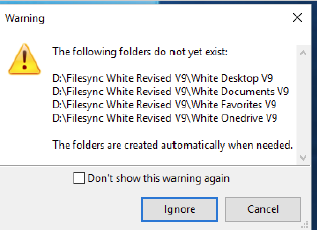

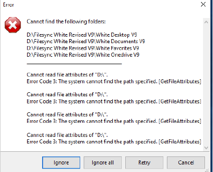

I made 2 errors. These are listed below. My questions is whether my saved configuration would have remained intact and whether it can be safely used for continued synchronizations without having been corrupted.
First error: I have a saved configuration containing four folder pairs and clicked "compare" with the wrong backup drive connected to my laptop. I received a warning that "The following folders do not yet exist" and then the paths to the four target backup folders were listed. The message at the bottom was that the folders are created automatically when needed.
Second error: For the same saved configuration as above, I clicked compare without any backup drive connected to the laptop. I received an error message that my four target backup folders could not be found (paths were listed). Then there were four Error code 3s stating "Cannot read the attributes of "D:\". Error Code 3: The system cannot find the path specified . [GetFileArributes] (D is the backup drive). I assume that since there were four Error Code 3s, there was a separate error code 3 for each of the four backup folders.
The error messages are attached.

- Error Message 1
- Error Message 1.png (18.07 KiB) Viewed 5903 times
- Error Message 2
- Error Message 2.png (31.3 KiB) Viewed 5904 times

The errors won't make any difference to your configuration file. The configuration file only gets saved when you physically give expressed permission for it to be saved. This is very useful. Let's say you have a configuration set up the way you would like it to be and that you have saved that configuration. Now let's say at a later time you want to experiment with changing something for that configuration -- just so you can test something out. Well you can modify the configuration in FFS, then test your change. If you find that you don't like the change you made, no sweat, just, in the configuration file listing, click on another configuration, or click in some empty space in the listing -- FFS will then ask if you want to save the configuration you just modified to test. Just click the "Don't Save" button and the configuration will remain in an unaltered state (as it was before you started modifying for your test). So, in short, configurations don't get saved unless you explicitly tell FFS to do so. So you can modify and test a configuration to your heart's content -- just don't save the changes unless you really do want to keep them.
With respect to backing-up to external USB HDDs and/or USB Flash Drives you might come across an issue where you have the external device connected to the computer but FFS, apparently, can't find the device because Windows has given the device a different "drive letter" than the drive letter the device had when you setup your configuration (file). If that happens then you could get the kind of errors from FFS that you have indicated above and might get initially confused as to why -- after all the device is connected. To get around that you can use what FFS refers to as specifying the path to the device via the "volume name" of the external device. Instructions on how to do this are here: Variable Drive Letters This is a very useful feature of FFS and one I use all the time for external devices.

So two folders (highlighted) were renamed to something different at the destination. Kind of scratching my head on this. I then had a look at the exclude filters that were being used for the sync and thought that the Exclude Filter *\desktop.ini might be the culprit. I deleted that filter and OK-ed my way out of the Filters dialogue, did another test sync and the problem with the renames disappeared. Hence, would seem that what name these folders get is in some way dependent on the desktop.ini files being present/absent at the destination. So, it would seem, if you want to avoid this problem you would need to devise a way of including the desktop.ini files for the sync of the Favorites folder, but only for that folder and its subfolders, assuming you don't normally want desktop.ini files included for other folders in you backup configuration. (I'm not sure how this could be done perhaps by setting up a Local Include Filter just for the Favorites folder. Not sure if this can be done but, don't have time to experiment with it just now.
- Posts: 36
- Joined: 17 Jan 2019
The reason for excluding \.* in the filter is that Onedrive creates hidden files starting with “.” and these files cannot be backed up by Free Filesync. Having said that, I have stopped backing up files from Onedrive because I am not sure that Free FileSync can handle these safely.
I assume that the exclude filter may be accounting for some of the source files not being backed up and thus leading to a difference in the file count between the source and target folders as noted in the Windows File Explorer Properties. Also, from your post it looks like excluding *\desktop.ini might account for the files being renamed.
The bottom line question is the following:
Since Compare in Filesync showed that the source and target folders matched perfectly after the sync, and there was a message after the sync that it was completed successfully, can we conclude that the difference in file count between the source and target folders as shown in the File Explorer Properties, as well as the renaming of folders such as the Favorites Bar, is due to the normal functioning of the Exclude Filter and Windows, and that the backup is therefore accurate and reliable and that there is nothing to be concerned about?
